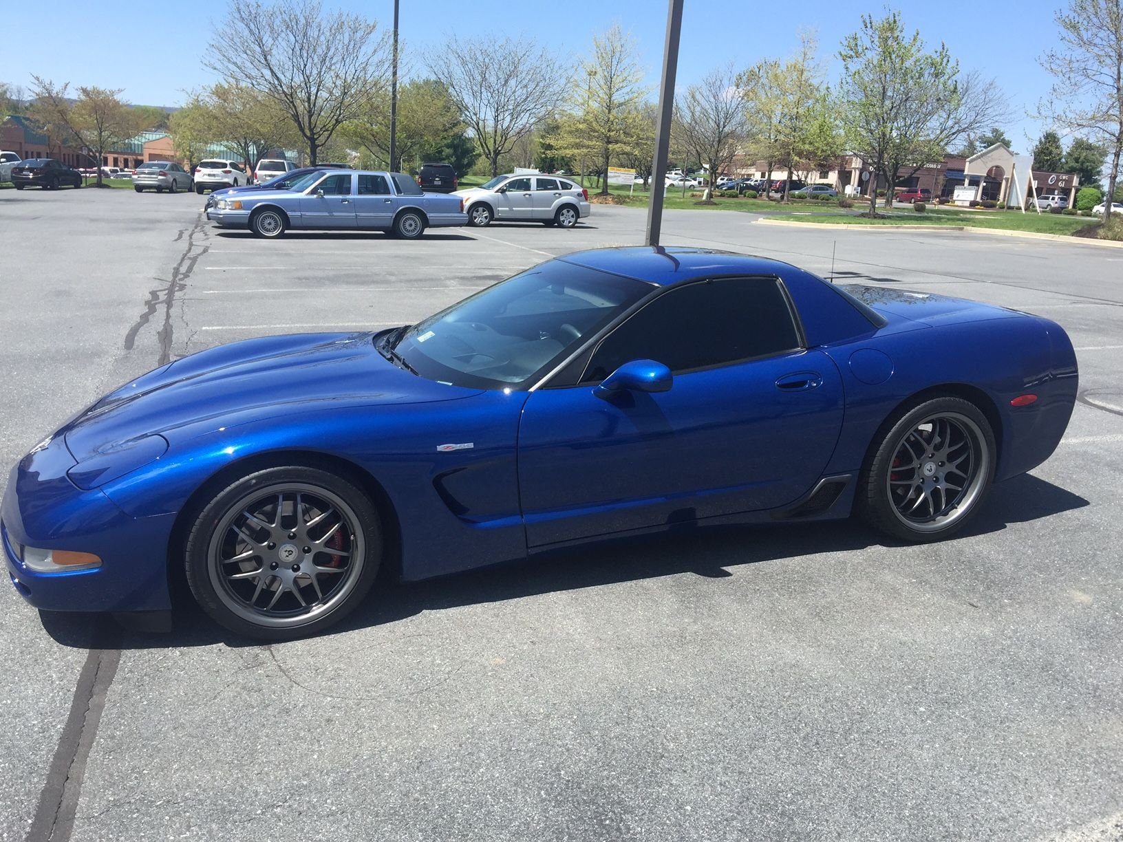

I came from a highly modded C4 that was an absolute $$ pit. So when I bought my 03Z, I promised myself that I would not go crazy on the mods for awhile. Here's what it had when I bought it, and what I've done since:
Had:
Pfadt swaybars and Johnny O shocks
Oil cooler
ducted brake cooling lines
Hurst Shifter
CAI
C5 sport seats
What I've done:
Headers - xpipe- hi flo cats - Borla ATAKs
New wheels size +1 (kept stock wheels with Nitto NT-5's mounted)
Need:
Tune
So I agree with the above:
Headers/Exhaust
CAI
Tune
Would be the first thing I do to go faster.
