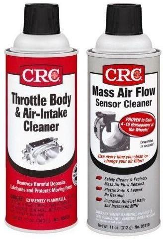

I'd also make sure my MAF sensor is clean. Also check your air filter and make sure it's clean as well.

No Mods what so ever, Cleaned throttle body / MAF beginning of summer, along with a new AF

Hi SgLou! I haven't actually checked this out on my Vette yet, so I hope I am not too far off base, but I had a recent situation with my DD where the throttle response seemed off. Turns out the TB was filthy. Once I cleaned it with TB cleaner it definitely felt more responsive. Could that be your issue?

Cleaned TB, MAF and replaced the filter
