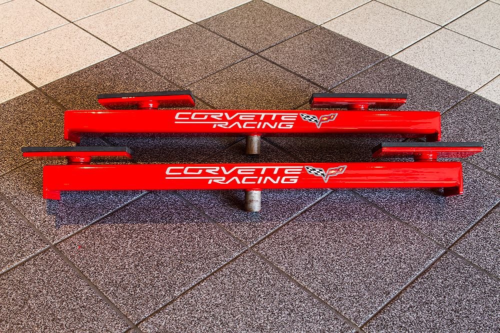

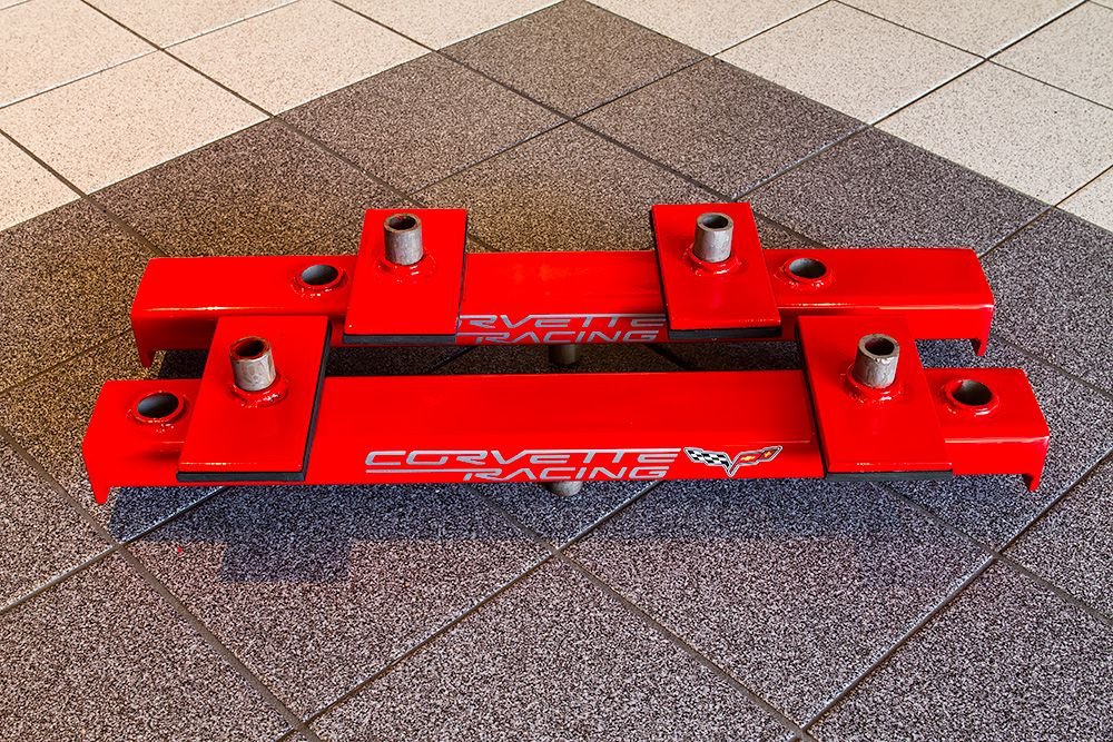

This shows part of my jacking set-up (when not using the Kwik Lift). The Jack Stands you see on the lower shelf in the 2nd photo come from U.S. Jack - they cost quite a bit more, but are made 100% in the USA. In fact I think they are the only jackstands still built here? Mine are the 3-ton stands, but they also sell 6 and 10 ton.
The ones on the top shelf came from Griots Garage, but are Made in China and I just use them for back-up sometimes.

Nice set up. Where died you get the Corvette Racing lift bar and how do you position the jack stands under the rear crossbar when using the crossbar? When I use a 2x4 wood block with my jack, I place the stands underneath the wood block. Do you need special flat top jack stands? The ones I have now have claw-like tops.

Lift bars came from Smith Fabrication. I place the jack stands a few inches from each end. I don't think you could use the claw-type?
This shows how to support them with Jack Stands...

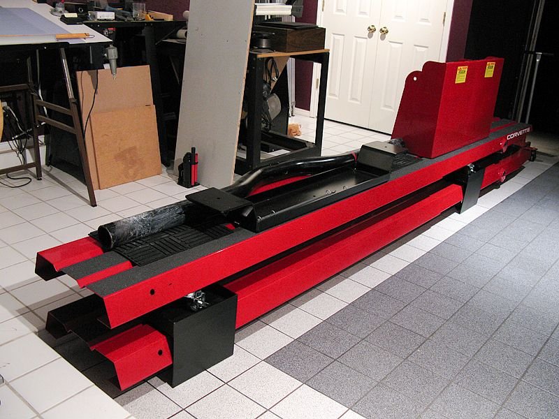

They are not cheap, but much less than my Kwik-Lift (which is great) - I even bought a 2nd set of MyLiftStands so I can raise the whole car in the air. I am even considering selling my basically new Kwik-Lift (which I have only used once) after finding the MyLiftStands. Each has their advantage/disadvantage. If you can leave the Kwik-Lift set-up it is faster and a great solution, but in my case, my garage has a very steep driveway leading into the garage which make it a bit scary driving up on it. I also do not wish to leave the Kwik-Lift on my garage floor when not in use as I would always be tripping over it. If you have a big garage, no problem.
The MyLiftStands take a bit longer to get the car in the air, but when not in use only takes up about one-square-foot of valuable floor space stacked! And, in my case, makes my steep driveway a non-issue.
If you have room and a fairly level garage entry (or work outside) or you lift your car often, the Kwik-Lift is awesome; however it weighs about 600-lbs vs. the MyLiftStands which you can pick up with one hand!
My Kwik-Lift... as you can see it takes up some floor space even when torn down...
