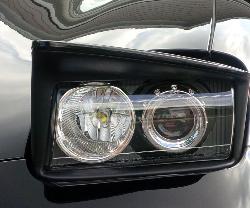

Like many, I identified the need to upgrade the lighting on my C5 for practical night driving purposes. I grabbed a set of LED tails and turned them into HALO versions after a dude rear-ended me (no damage) just two weeks after buying the car. People behind me now had better hope they are not epileptic.
The headlights had to go. I love night driving and I needed better beam direction and also increased lumens. I figured these are simple parts, all kits must be equal, and I grabbed a set of lows, fogs and highs off a popular corvette vendor for mods. Fogs have always worked and still do. Lows would come on slow, but I'd have to cycle them a few times before they would both light sometimes. Highs.... which you typically want "on tap" instantly... would barely barely come to life... you'd be in the dark for 10 seconds. So I got RadioFlyer's Hi-4 wiring conversion which allows lows to remain lit when highs engage. This HELPED... because I wouldn't go blind when the highs took half a minute to hit temps.
Long story short... the ballasts from this common vendor crapped out. All of them. Two died an internal death - just stopped working. One melted an ignitor wire.
Impression when working of these vendor lights through factory lenses (no projectors): "when working" it was a huge, unguided amount of light put out. Colors were pure from the bulb. Light "everywhere" especially the highs. Positive note: you can see the reflectors on a parked state trooper from two miles away. Negative note: they will see YOU first, LOL. I was not a fan of the slow starts and frequent need to cycle the lights on/off to get one to light. This was due to relying on the factory wiring system to the headlights and new ballasts, which, on a '99 is certainly not up to snuff. Still, once you took a minute to get the system lit, incomparable experience driving and having the entire world in front of you lit with daylight. GREAT for solo driving back roads. But not at all appropriate on highways or trafficked roads due to the open and non-projector aimed light.
My second generation involved some fixing / upgrades.
Those first ballasts kept dying. I'd guess the nature of having to let one bulb get up to temp and then cycling the system off and back on is just not good for the bulbs OR the ballasts, but the bulbs never died - just the ballasts.
*** This is the point in our story where I step forward and say, due to the expense of the first round of parts, and knowing that upgrades are necessary.... the expense of two systems FAR outstrips the expense of "doing it right" the first time and spending just a little bit up front on a good unit from RadioFlyer. Shameless plug: RadioFlyerInnovations' C5 Parts + Services. I'm not getting any kickbacks for posting this. George, and we're glad he's back, puts together top quality parts and accessories at a fair price. ***
So really, I advise you to skip the generic kits with bottom dollar chinese parts and just go to George. You get the results you want and a factory finish in terms of reliability, appearance and function. Git 'er done, son!
Back to our parable...
If you must "do it yourself," then here is what I have gone with and what works for me currently.
I did get one of the ACA housing kits online. Again, go to George for this because he mods the angles and uses different lenses. I have the ebay chinese version because the winter when I did the mod I was low on mod money. The outcome for me is fine, BUT you get what you pay for in terms of the lense clearly affects the color of the low beams from their pure white to just slightly dulled/yellowed.
Just as with rifles.... you don't buy chinese glass.
That said, and here we come finally to the end, what has worked best for me since I was bull-headed about it and had to do it myself, was to grab some Morimoto 35 ballasts off TheRetrofitSource, mounted them inside the frame rails next to my BPP intake (may have to move them with the SC install coming up), and some ignition side
extensions extensions
to make it work. The absolute KEY being that I ran individual power feeds to each ballast off the positive terminal. Only one is powered off the factory wiring.
By running the individual power lines (I used RadioFlyer here), they all get adequate power to light. By using the Morimoto ballasts, they all light quickly and I don't have the slow-to-light issue. It finally works as it should, and as I expect it to.
Caveat: now I want to ditch the ACA housing and go with a Light Cannon type of mount where both sets of bulbs have quality projectors.
Overall expense for me? WAY. TOO. MUCH. FOR. WHAT. IT. IS. WORTH. (just, to me, it's worth it) So I'll refer anyone looking to upgrade lights again to just go with RadioFlyer the first time and be done.

Another vote for the RadioFlyer ACA upgrade. No, it is not cheap. But I didn't want to spend time and money going down the hunt-down-the-components-and-assemble-it-yourself road.
I wanted a proven product where I could do it once and move on to other areas.

What I learned.....
3 years ago I purchased my first C5. I love tinkering with the car and am one of those guys whose has yet to find a mechanic who meets my standards. As a result all work is done by me personally.
Like you, I quickly identified the OEM headlights as crap. I looked around at options and found a few including simple bulb replacements, HID kits, projector housings, etc.
At the top of the list was "Radioflyer Innovations Bi-Xenon ACA Projector Headlights" for $650.
I thought that was an amazing amount of money to spend on headlights.
Not that I couldn't afford it, it just seemed like an exorbitant amount, surely there must be a more cost effective way to improve the headlights.
I started with a quality HID kit for around $100. Initially I thought the results were better, but over time I came to realize that it wasn't that large of an improvement.
Next I purchased some ACA projector housings from Ebay for $200. Now we had something, this was definitely an improvement over the stock housings, the light was not as diffused and was more focused in the front of the car.
I still wasn't as comfortable driving at night at speed on a dark road as I wanted to be. All of my other cars seemed to light the road more effectively.
One evening I had the opportunity to ride in a C5 with a Radioflyer Bi-xenon kit installed. The difference was absolutely astonishing. I could not believe how well the road was lit up as well as the definitive demarkation of light about 24" off the ground. From 24" down and extending past the width of the car on both sides, it was like daylight, from 24" up it was almost total darkness, clearly this would not effect oncoming drivers in any way but had substantially increased the C5 driver's night vision.
This is exactly what I had been trying to achieve. I guess the missing part of the puzzle was the Bixenon. I began research Bixeneon kits to add to my housings and quickly discovered that this would be another $200 or so investment, at that point I still wasn't sure I would have the right projector, installed correctly in the housing as far as depth and angle goes, to achieve the same result as the Radioflyer version.
I would be $500 into this experiment with no guarantee of achieving the same results.
Removing and replacing headlight housings on a C5, is not really a difficult job so much as it is time consuming.
I decided to join that group of guys who I thought had spent way to much on headlights and boy am I glad I did.
I just finished driving back and forth to the SEMA show in Las Vegas from Los Angeles late at night. The drive is about 4 hours each way across the desert. Did I mention late at night? You can use your imagination about what happens to a C5 owner late at night on a desert highway, but suffice it to say I thoroughly enjoyed the drive, .
A buddy of mine pulled up in the lane next to me at speed in his C5 with stock headlights and was absolutely amazed at the difference between the two. He actually turned off his lights, the Radioflyer kit was so good it was almost imperceptible that is lights weren't on.
I always ask myself two questions after any mod.
1) Would I recommend this to someone else?
2) Would I spend the money and do it again?
In this case I can answer yes to both questions.
I thought I would never spend that kind of money on headlights, and now I would do it again in a heartbeat!

After having these for about a month I am still amazed at how much safer I feel driving at night.
I feel the same way too, and I've had my RadioFlyer Bi-Zenon lights since April 2014. They really are worth the price.

Just got a set used set of real ACA's off the for sale section here last week, this week they are heading to George's for the mod, could have saved a bit ($50) by installing his kit myself according to him, but at this point I figured I've saved a bit by buying the used like new lenses and by letting him mod them I know they will be 100% correct!
I can't wait but do sorta dread the headlight disassemble in order to install them
I'll bite. What are "real ACA's"? How do they differ from the ones from RadioFlyer?
