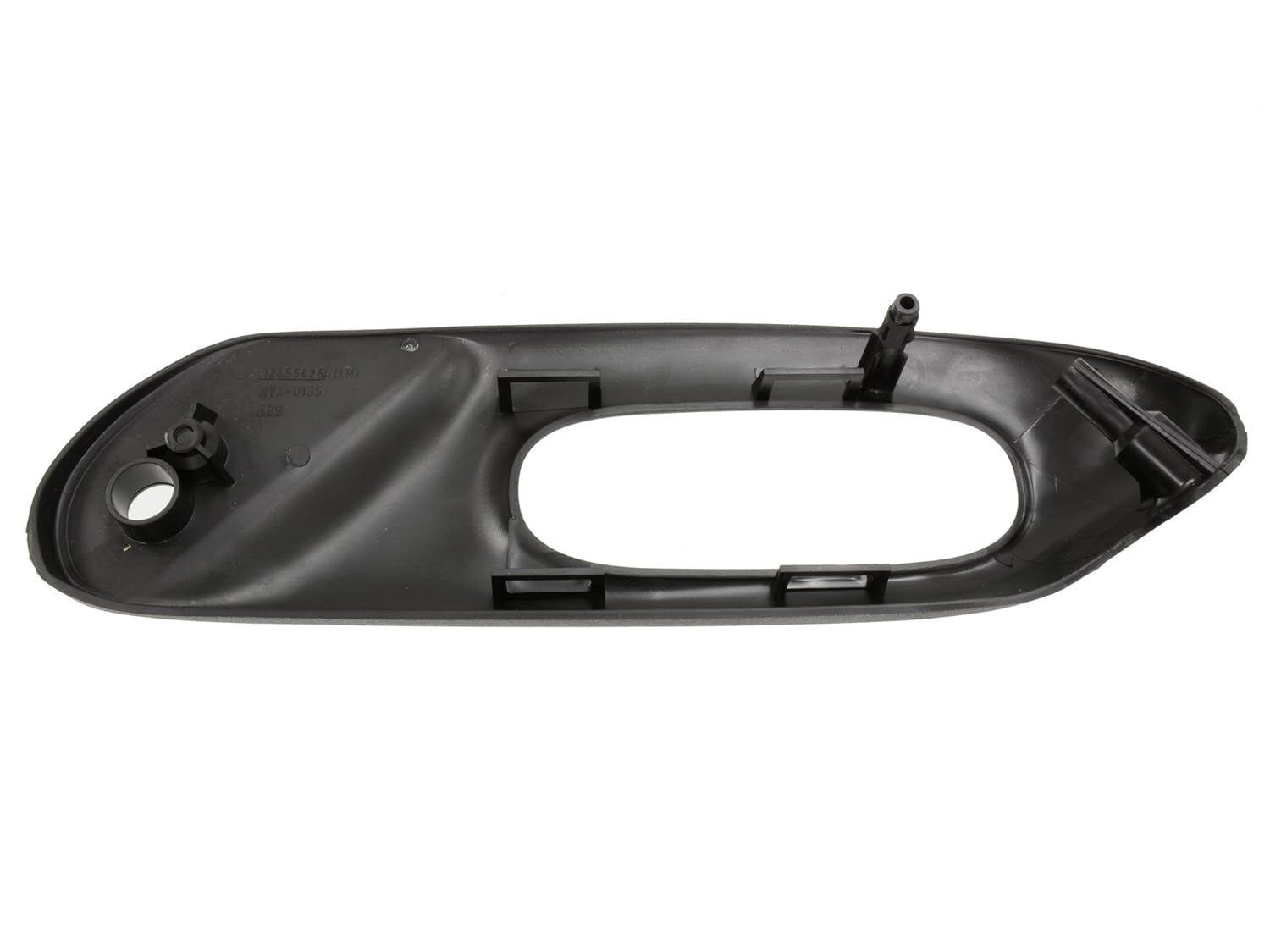

As to your second issue, the plastic panel is attached to the seat frame by a screw in the front. The screw goes through a tube and is countersunk (compared to the surface of the panel). At least on mine, the tube can break at a point above the screw head, so the bottom of the tube is still screwed to the frame, but the top part that's still attached to the panel breaks away, allowing the panel to sag. You can either replace the panel, or remove it and try to repair the tube.
Here's a pic of the backside. The tube I refer to is on the right (not the one on the top--that's just an alignment peg):
You can see that the tube is flared. The screw head is around the part where the flare occurs, and breaks off there.
