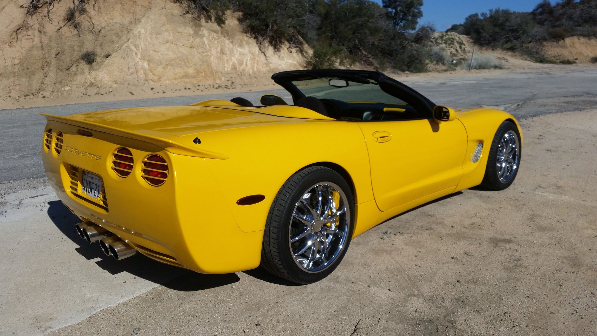

I am lowered on the stock bolts 1 inch all the way around which is the max you can go on stock bolts safely, I have 19/295/30s on the rear with 1 1/2 inch wheels spacers ( to bring the tire out to the edge ) and 18/265/35s on the front with 1 inch wheel spacers. I think with your 20 in wheels that would be plenty of lowering otherwise you may be looking for rubbing issues especially in the front when you turn.
B.T.W. Mine is a 1999, But I am sure the suspension set-up is the same on your 2000
Here are a few pics of my set-up

That looks really good. The perfect height in my opinion. I'm sorry to hijack this thread, but now I have questions. I'm ashamed to say that I've owned my Corvette for over a year now and I did not realize you could lower it without buying any additional parts. That being said, when you lower it on the stock bolts, do you need to get an alignment done? Or does it retain the geometry enough to not need it?

Stunning!
