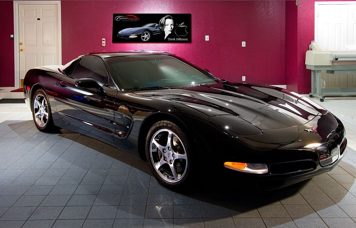

I have been using various Menzerna Polishes and pads with my Flex 3401 for years on my C5 with great results. I detail mine about twice a year and it takes me about 2 hours per panel by the time I go through all the polishing steps, apply the Zaino coats, etc. Pretty much kills a weekend.

WELL DONE! That's how black is supposed to look. Truly exceptional man!
