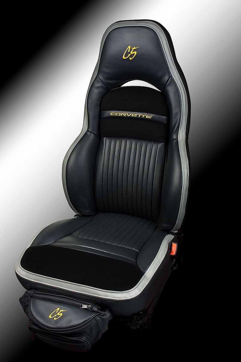

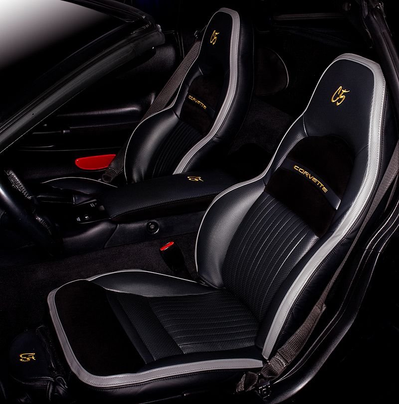

My Caravaggio GT seats, retains all electric functions except recline of course.
This is a modded C5 Z seat
frank

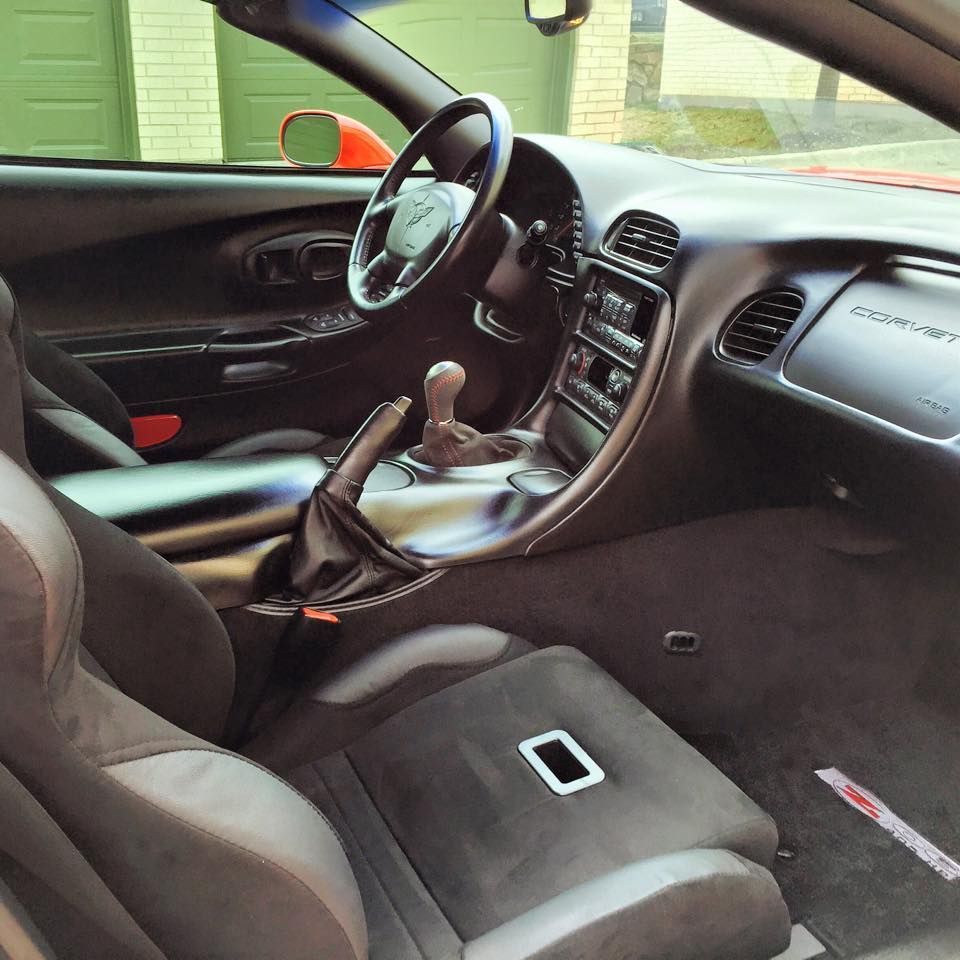

Love my corbeau A4's. Way better than stock!! Sorry its a bad pic. only one I have.
