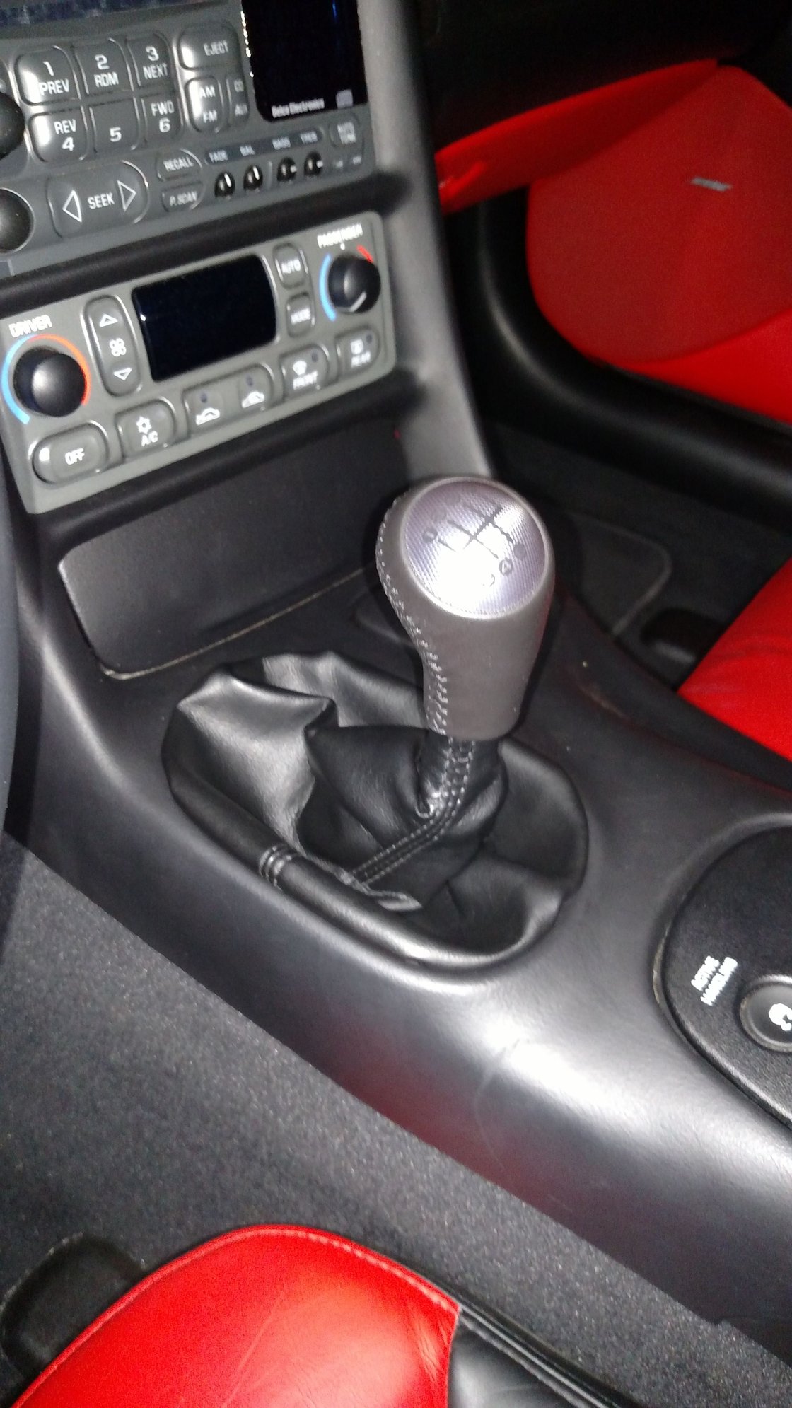

Old Dec 13, 2015 | 12:58 AM
Verrückt ZR1's Avatar
Verrückt ZR1
Joined: Jan 2014
Posts: 3,153
Likes: 859
From: Rio Rancho, New Mexico
Originally Posted by McFly09
Yes and the stereo and A/C controls match my 05 Silverado. The point of keeping the stock shift **** is just to keep the car looking factory, it's just something I like to do. For me personally the C6 **** certainly looks nicer but out of place.
You can keep the factory **** if you'd like. MGW shifters can be ordered with a threaded 9/16" shaft for C5 equipment, or 5/8" for C6 I believe. No big deal. The C6 shifter actually looks wonderful in our old C5's. Perhaps the picture above didn't do it justice (even though I thought it looked great. ). Here's another, just in case you can be pulled to the dark side.
P.S. The **** isn't nearly that light in person. It actually blends very well with the rest of the console, and is much more comfortable in the hand. Just my crummy phone camera at work.
