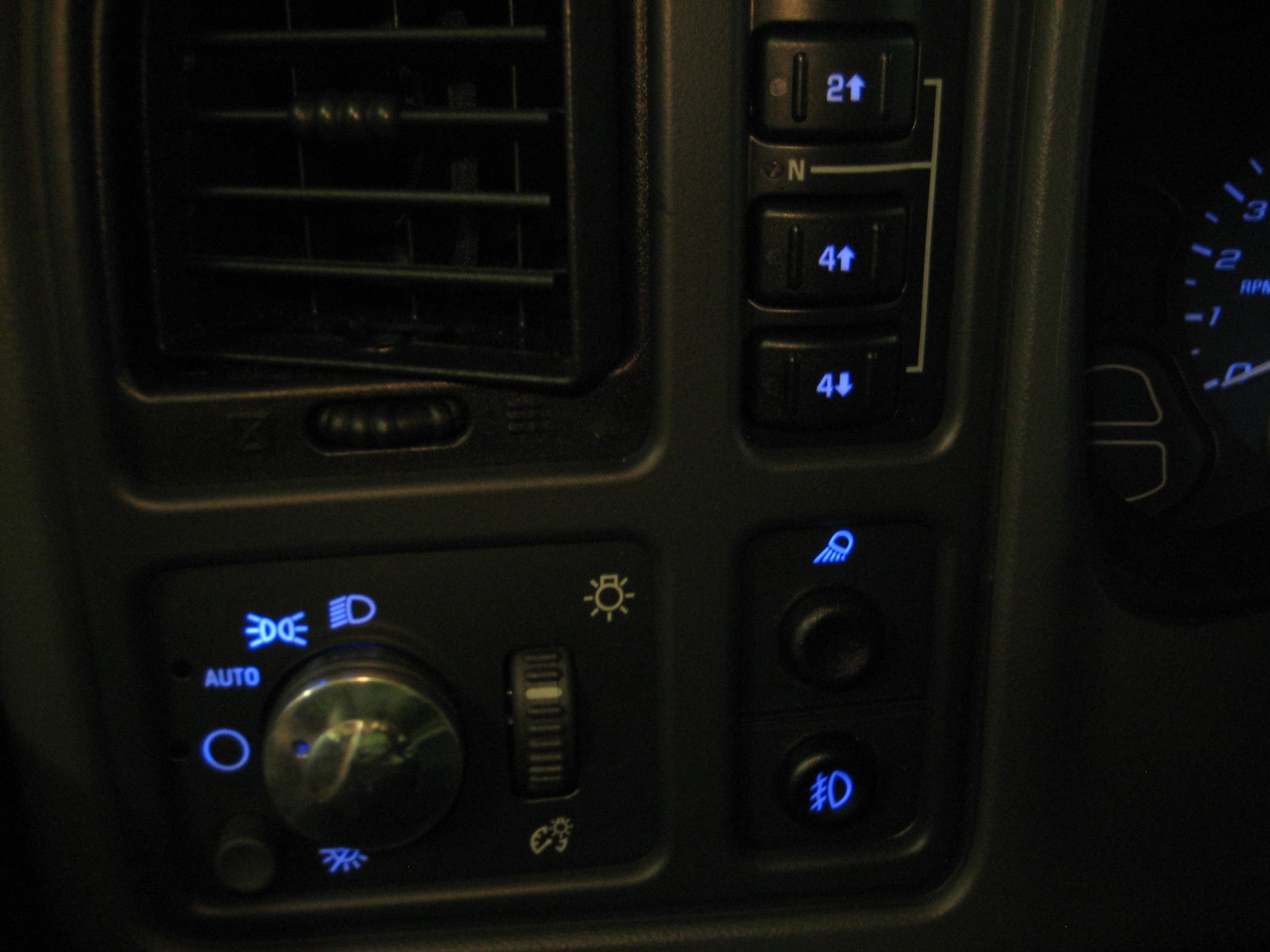

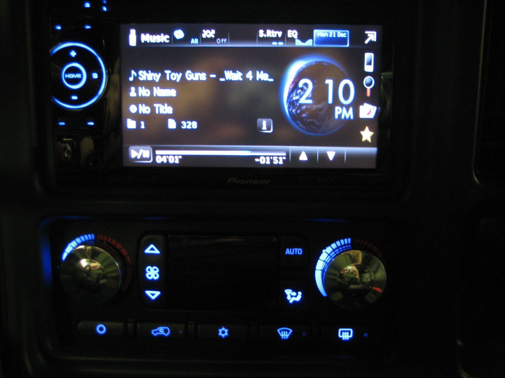

My 03 GMC lights went out also so I changed all mine to blue to match my radio !!!! It was a pain but after I did my truck the vette was easy !!!
I am thinking on doing the vette illumination lights this winter !!

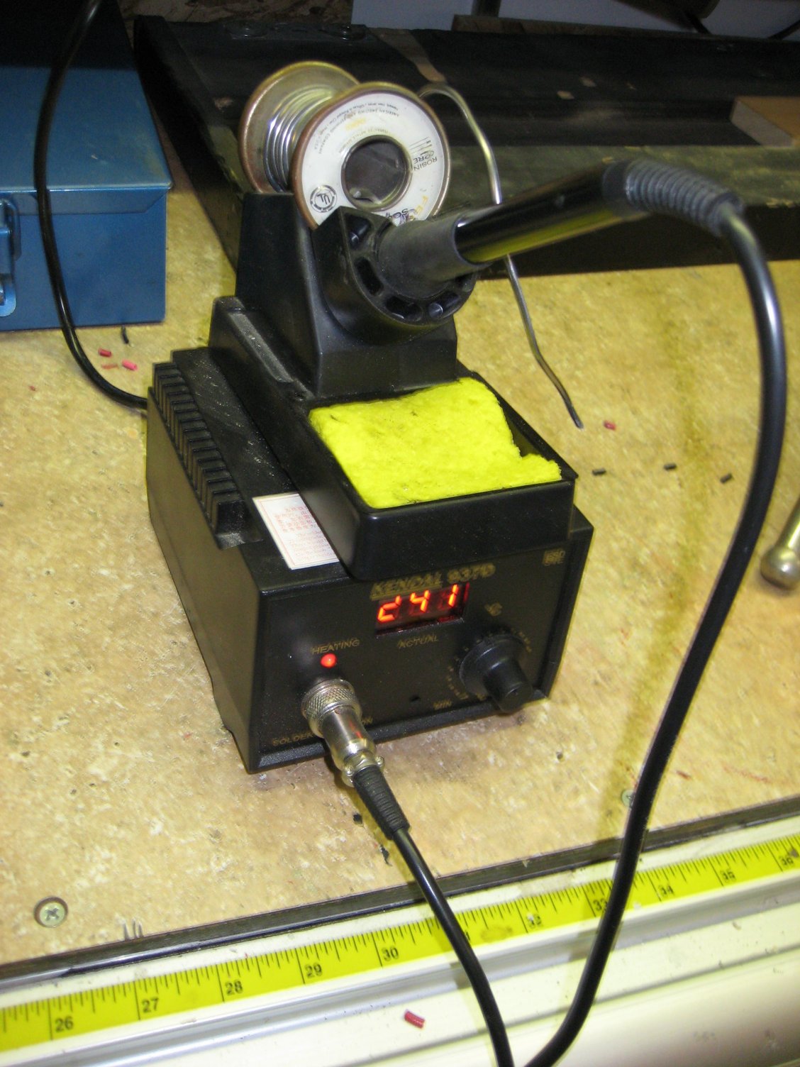

This soldering station from Amazon helped also !!!

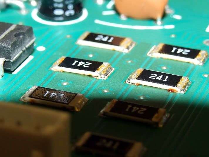

All of the resistors on the power supply board have cold solder joints. They all need to be re-soldered.

Pull your HVAC unit. If the "241" resistors on the board look like these:
See how the middle one on the left has a crack between the solder on the end of the resistor and the circuit board? You just need to basically reflow the solder on each end.
If you have any bulbs out on the button panel, it's a good time to replace those too: melt the solder for the busted ones on the back of the board and pull the leads out, then clean out the hole and push the new bulbs in and solder the back side, trim the leads.

I picked up a 30 amp soldering iron from Harbor Freight. I will try the soldering this week and see what happens
