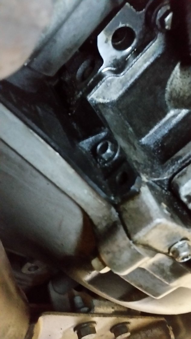

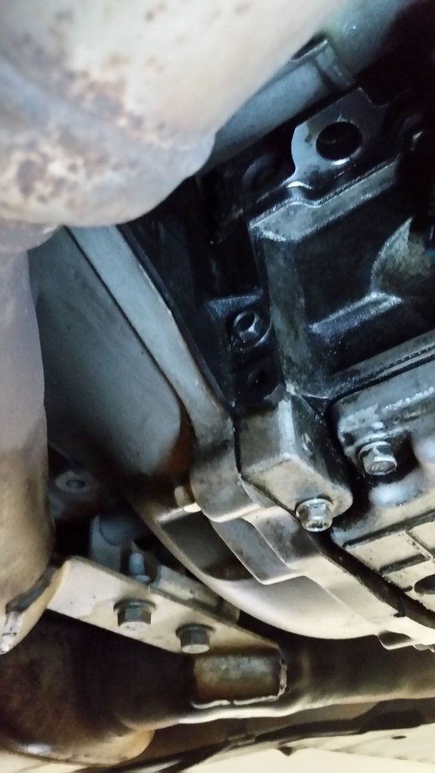

2004 coupe. Should there be a bolt in the lower hole in these pictures? Just below the black bolt on the black bracket? This is the passenger side just aft of the oil pan. Thanks in advance.

just a casting hole !!!! opps sorry didn't know what you were looking at ??? I think there should be two bolts for that cover but not end of the world !!!!!

The bolt that appears to be missing is the bolt that holds the transmission oil cooler lines to the block on a A4 equipped C5. Yours appears to be a 6 speed thus empty hole.

Yes mine is a manual. Thanks for the quick response! I haven't been on the forum much the last few years (I always end up spending more money when I see everyone else's customization) but definitely a great group of knowledgeable people.

Ya Jack, I had to go look at mine ,really thought there were two bolts, just one !!!!!!!!
