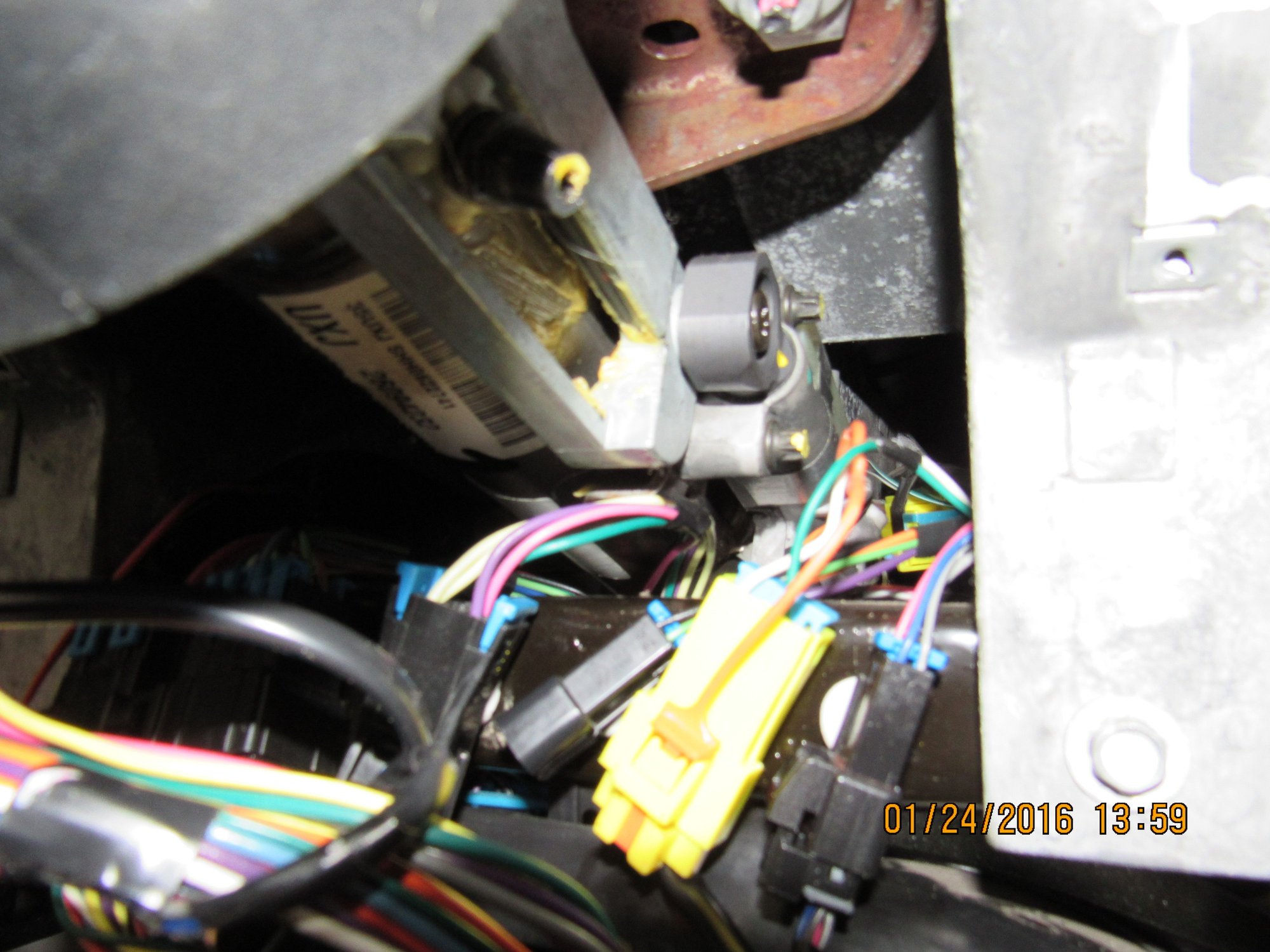

I am sure that it is the SWPS. It has thrown the C1288 code on several occasions as well as pulling to the right when the Active Handling light comes on. I believe that I have the CLB installed on my steering column and not knowing how this works, I prefer to take it someone who knows what they are doing.

Last edited by flarick; Jan 24, 2016 at 01:25 PM. Reason: Needed to include pics of steering column

I was going to do this myself, but I think I have the Steering Column Lock Bypass installed on my car. I don't know exactly how this works, so I think it might be best to take it to someone who does.

The device on the side of the column is the telescopic motor. To get the column out of the car you need to do the following;
1. the two studs that the column mounts with at under the IPC need to be removed. these have t start style head on them, I forget the size but is should be about a 7mm or 1/4 inch socket.
2. to get the column out it needs to be gently rotated as you are pulling it out. be careful not to turn the steering wheel.
It may also help to remove the drivers seat. I have had to do that a couple of times.
Let me know if you have any other questions.
Gary

Thanks for all of the great information on my problem. I will remove the steering column Thursday when I am off work. I appreciate you taking the time to answer my questions.
