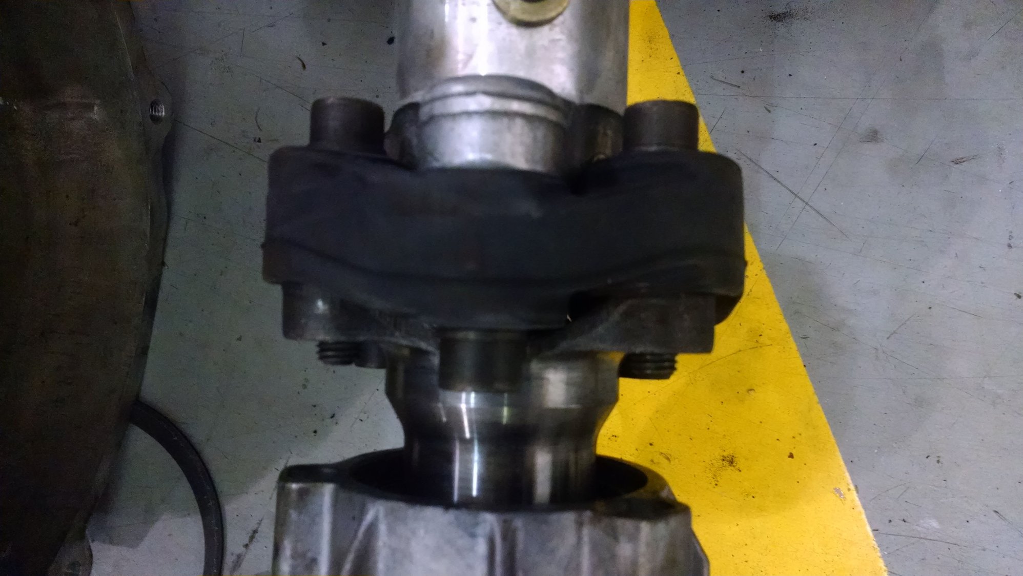

C5 auto 3.42 rear tq tube coupler
U have to pull tq tube to check.
Front tq tube coupler when they get like this u definetly know it

Thanks, I was afraid you were going to say that. I have a slight vibration at about 73mph. It's driving me crazy!!!
