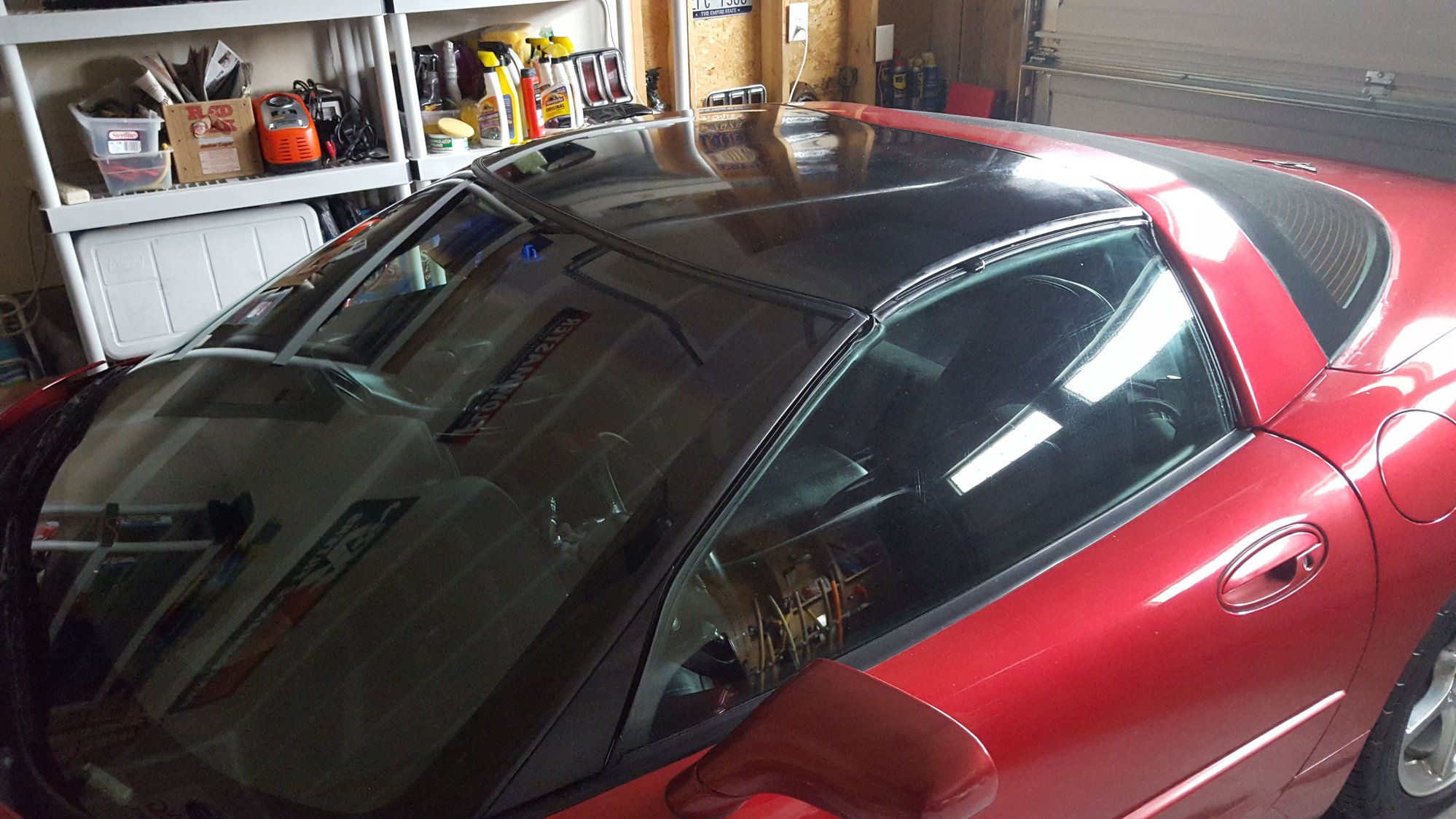

Just wanted to give thanks to the wet sand and polish thread can't locate right now but did the trick for my transparent top. I wet sanded with 2000 grit until no resistance, then rubbing compound, then wax looks great!

Agreed, where are the pictures???

hard to get a good one rain today...no before but after shows better reflection was dull.
