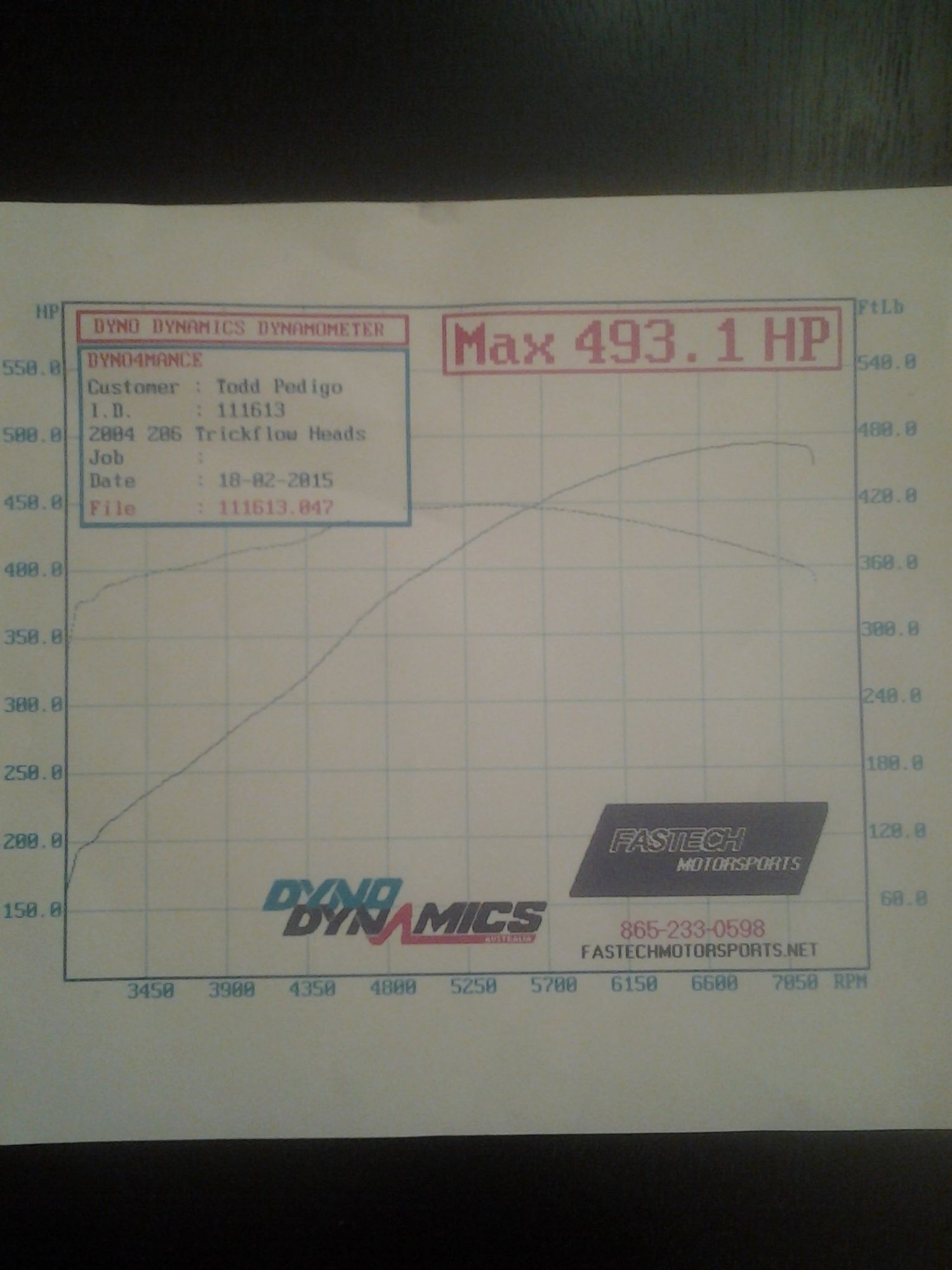

Does it have aftermarket heads, fast intake, the hp is possible if so but the tq is way too high normally around 420-440 with a 346 bottom end at those hp levels, if it's just cam and bolt ons and ls6 intake then probably anywhere from 400-430 rwhp
this is mine with heads, cam, fast 102 and the TQ is way lower

The dyno sheet says it has Trickflow heads....
Old Feb 17, 2016 | 09:18 AM
Verrückt ZR1's Avatar
Verrückt ZR1
Joined: Jan 2014
Posts: 3,153
Likes: 859
From: Rio Rancho, New Mexico
That's not the OP's dyno sheet...
