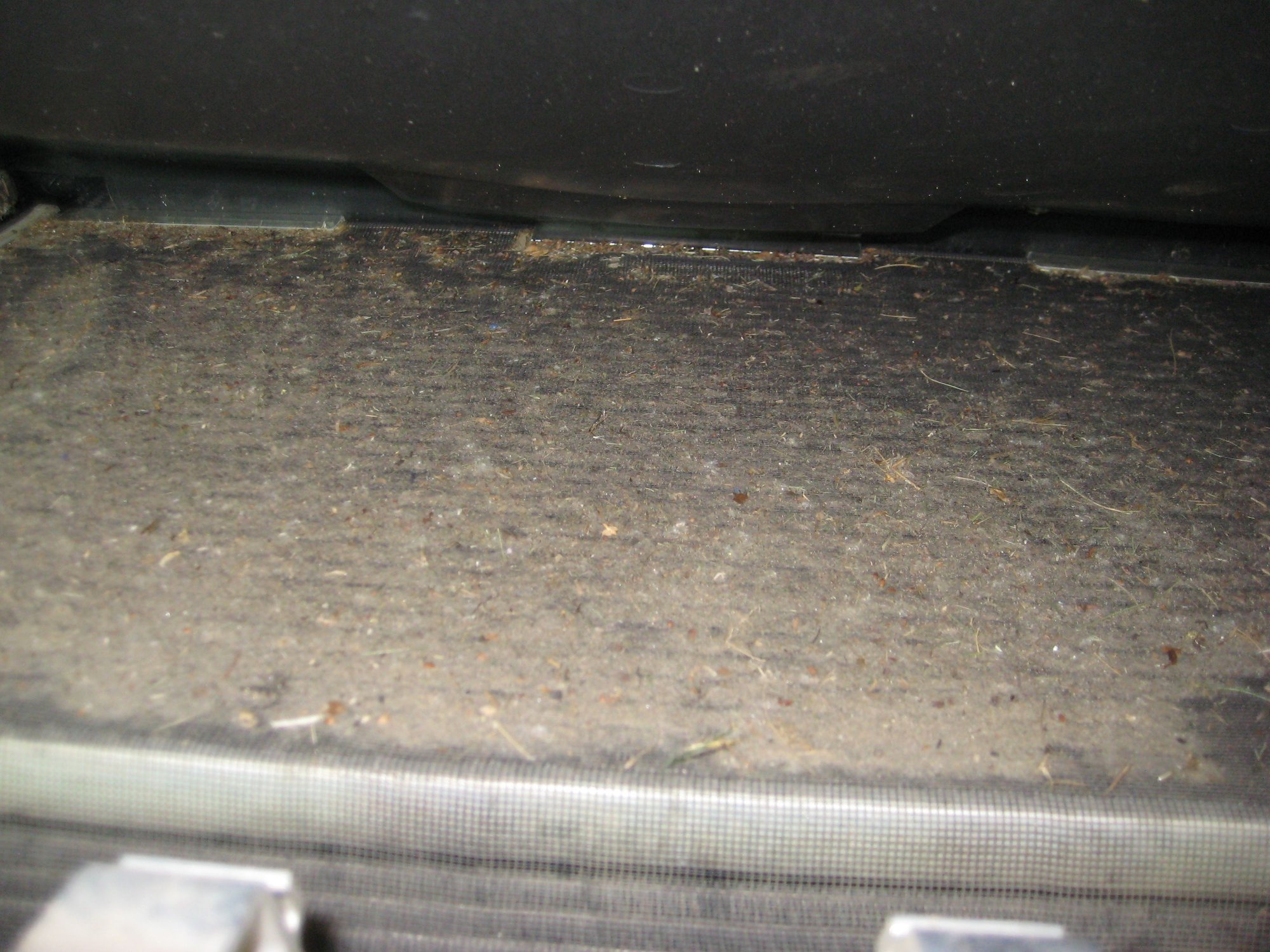

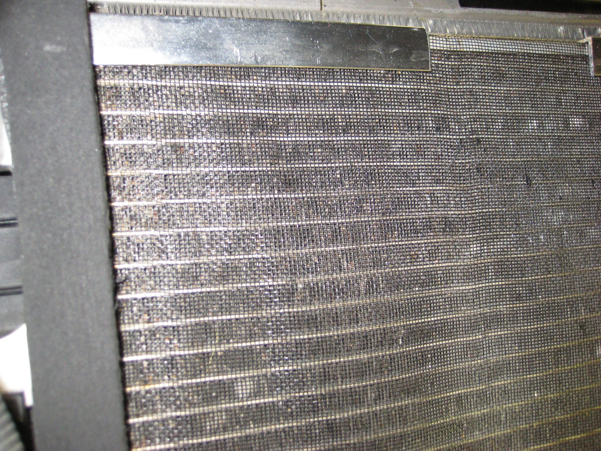

My first winter checking things on the car, I first used air on a long nozzle could not believe the crap that came out of the radiator,then I used a hose and even more came out, I had the hoses off so I decided to pull the radiator and on the ground with the water spray even more came out !!! I have to drive on dirt for a bit before pavement so I decided so make the next cleaning a bit easier !!!!

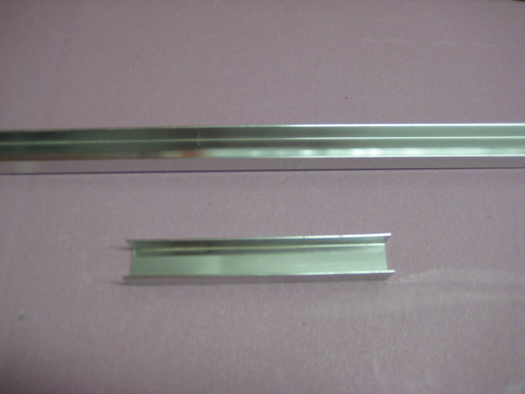

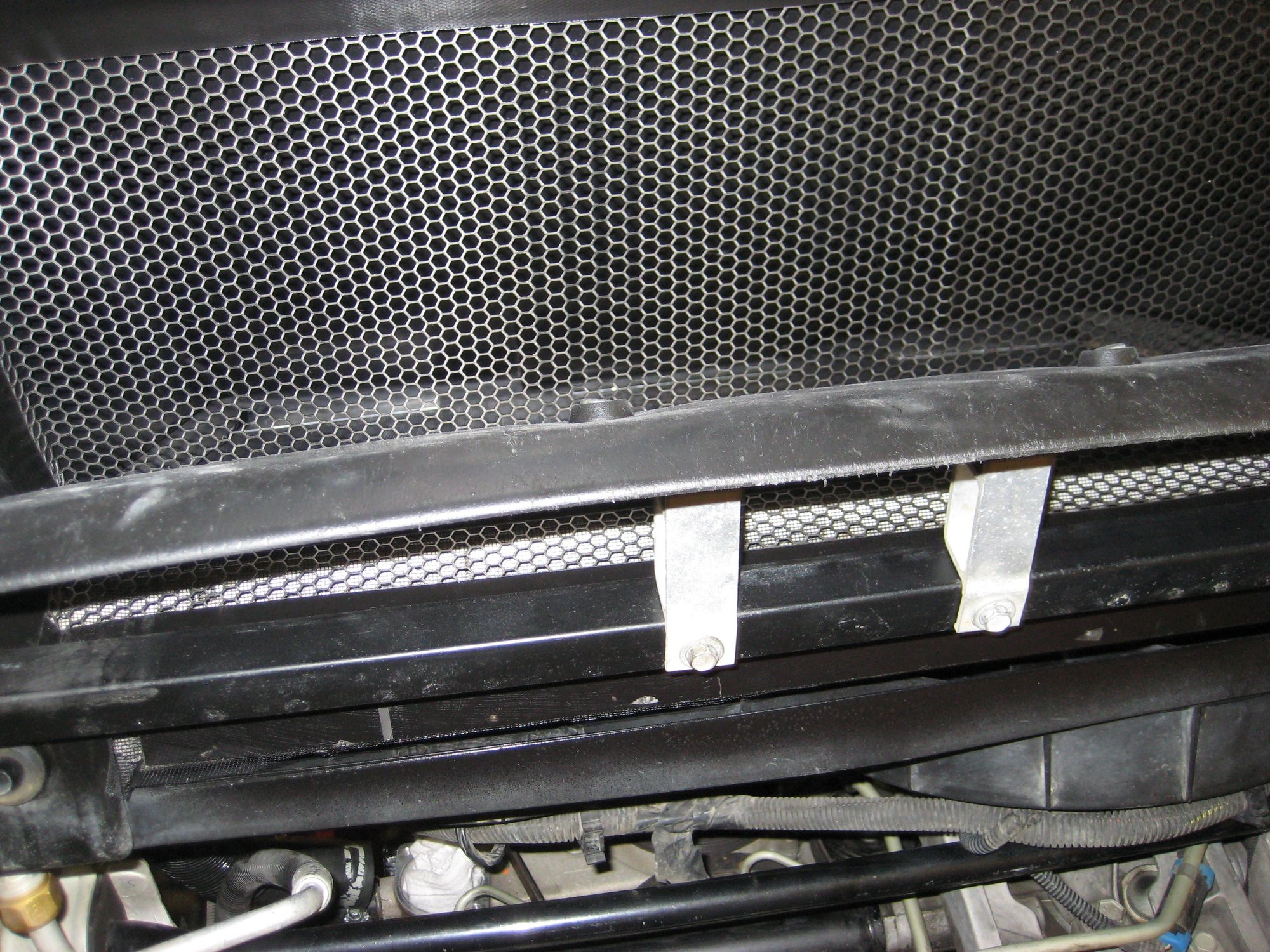

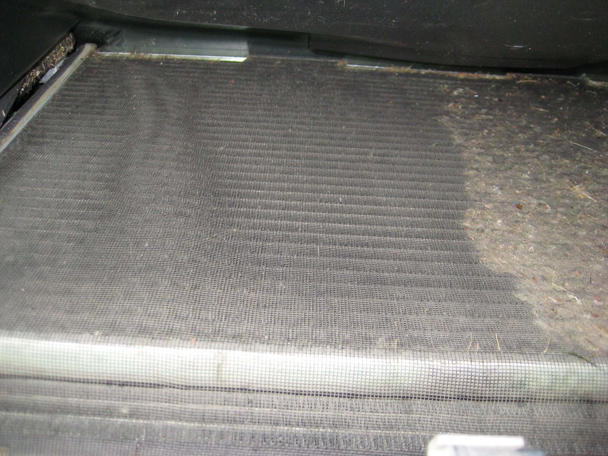

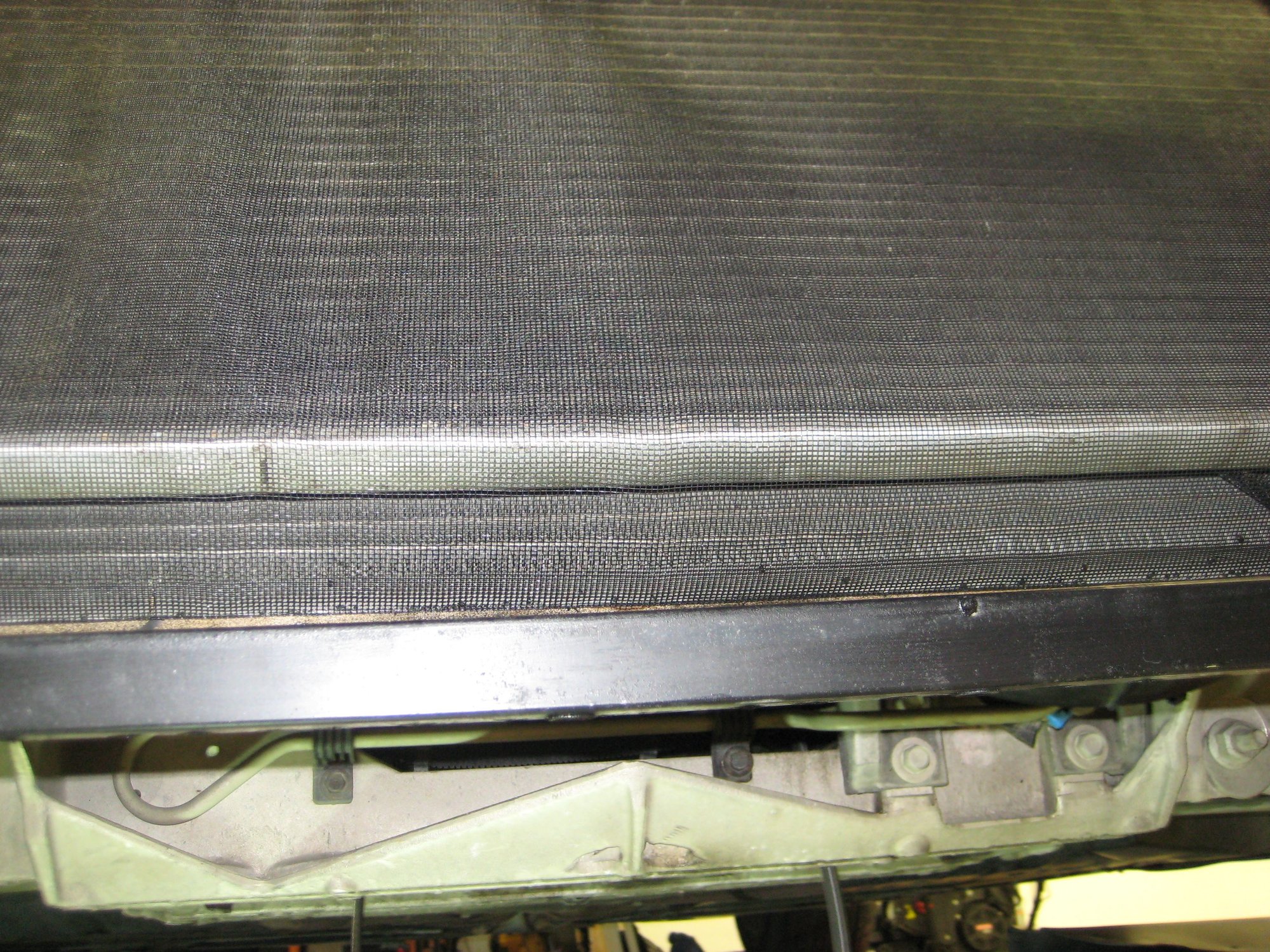

I used the aluminum channel to hold the screen to the top of the condenser core,on the bottom I cut a piece of wood to wedge the screen to the bottom of the radiator,made a bottom screen to get the big stuff. after three months this is what my screen looked like, but took me fifteen minutes to clean it !!!!!

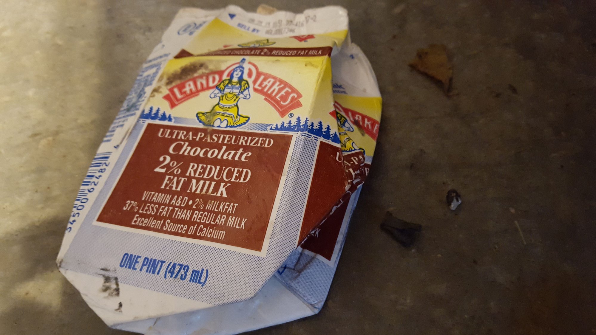

Last I cleaned my radiator this was jammed up in there.
In the past I've also had a McDonalds cup jammed up in there.

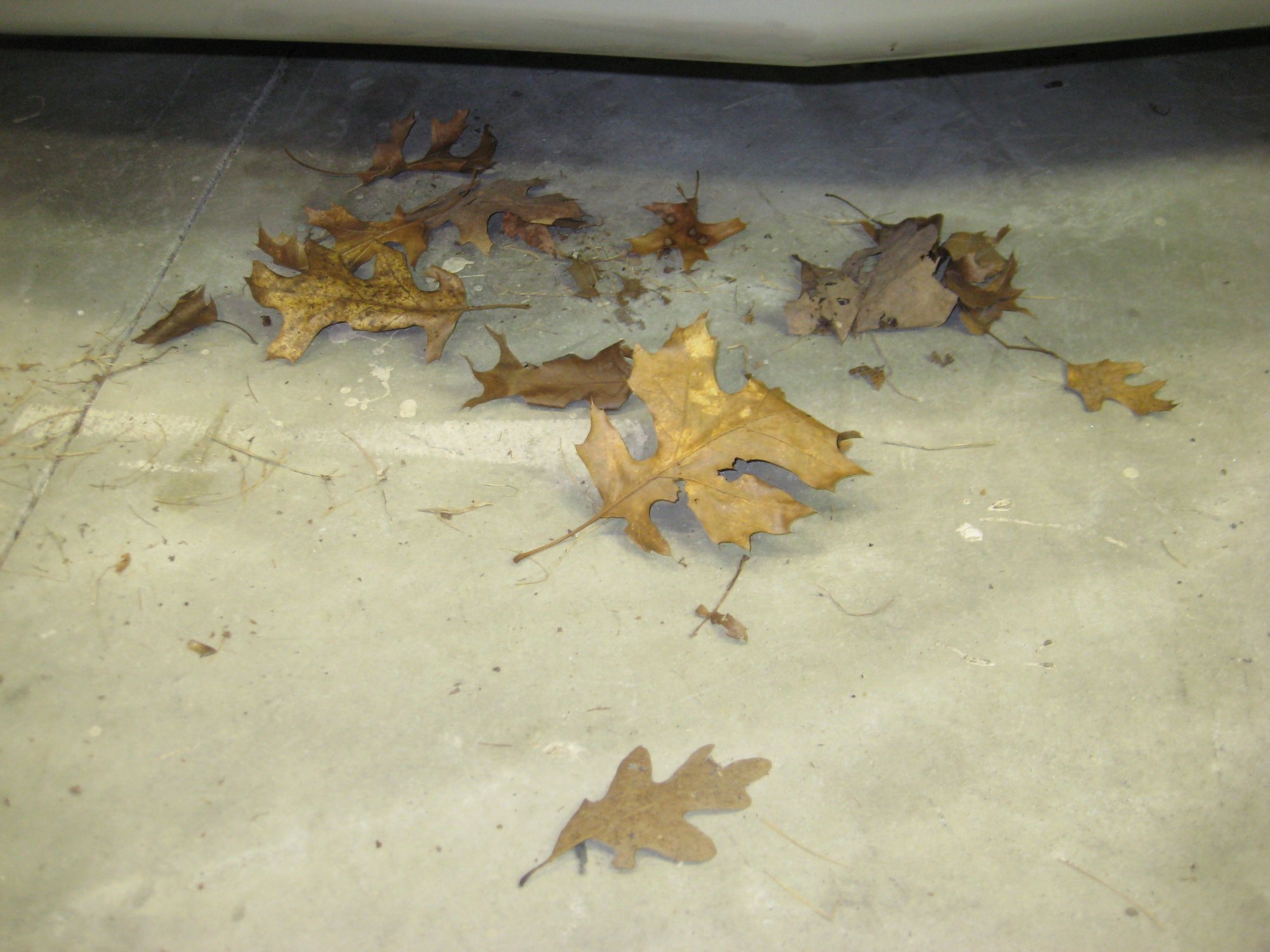

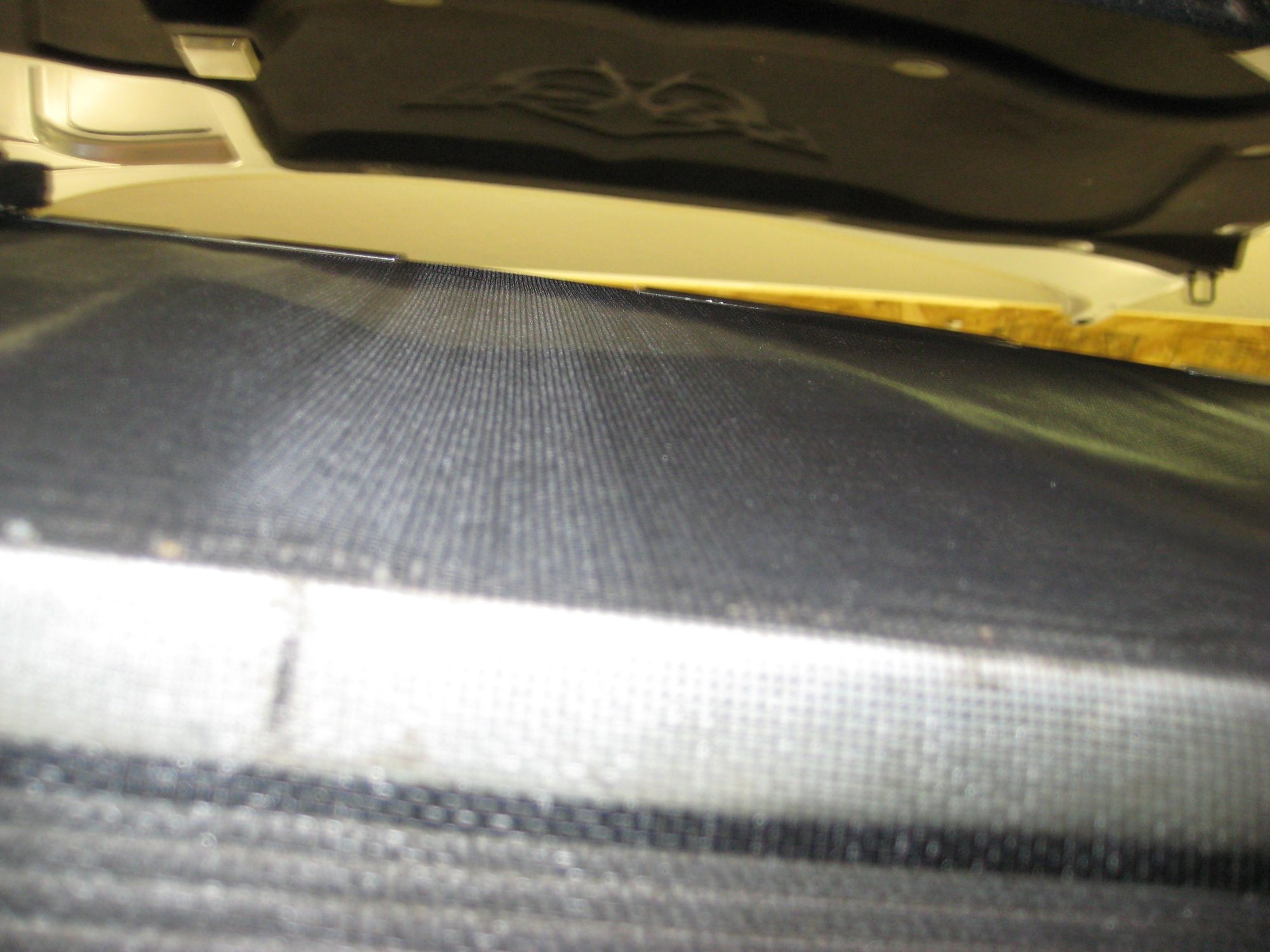

after my first drive with the screens in place I pulled into the garage and the next mor'n I saw this and thought where in the world did
that come from.(yep a bit ****) after I shut the car off all this was stuck to the screen until the fans shut off !!!!
