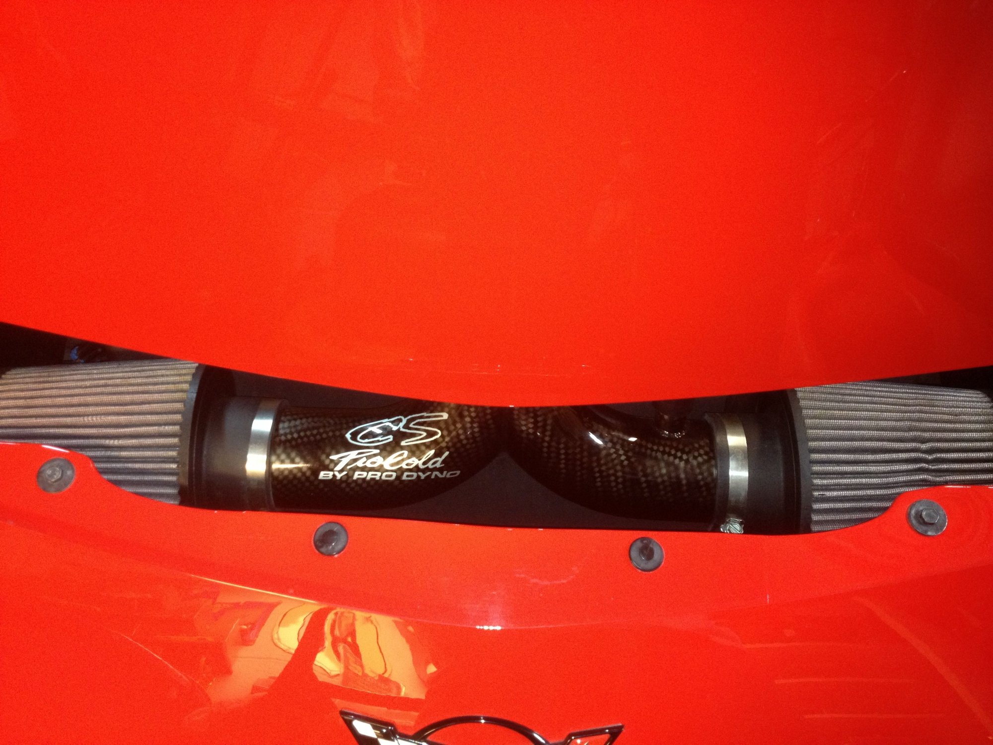

I took delivery of my car Jan. 98. I put this air intake on shorty after. There was not a lot to choose from at that time. I was not concerned about HP gains. Every magazine i read about the new C5 was the very restrictive air box that the C5 had. They were telling people that if it was ever redesigned that we should have ours changed. Well they never did. It is better than stock. This is K&N. The computer adjusted nicely.

It looks real good Frank, and if you can get the air out a little quicker with a high scavenging and less restrictive exhaust system. there will be some gains over the stock box. Also it will lean out an already rich factory tune.
