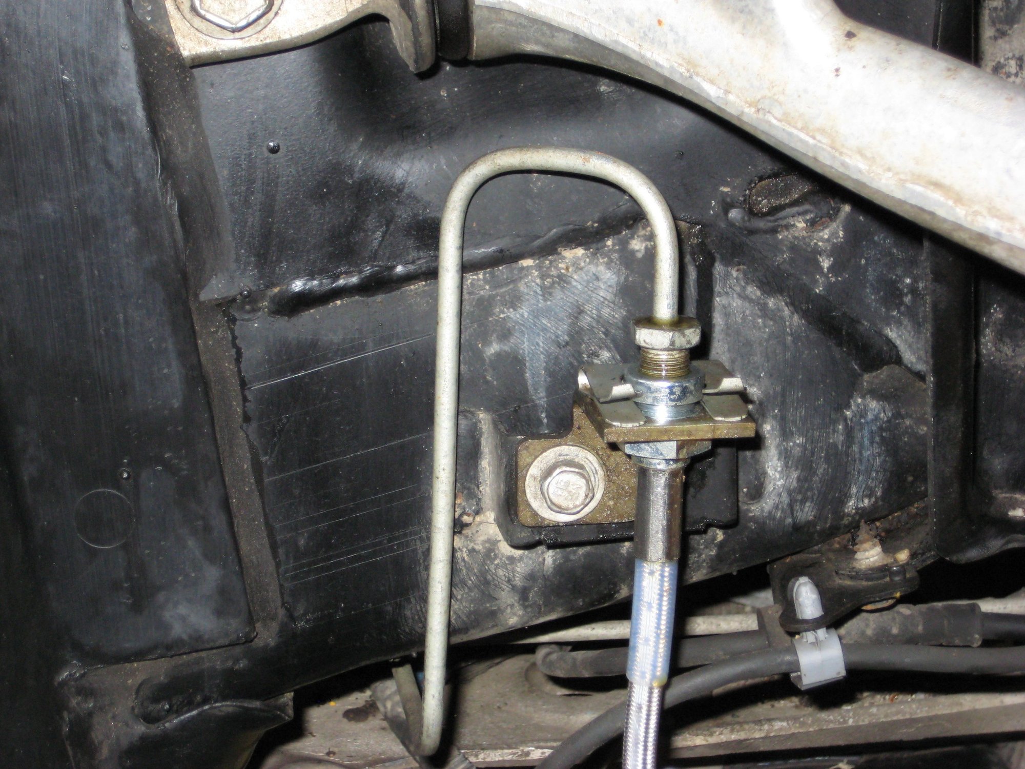

1. This is a question, my car is 16 years old with 67,000 (17,000 the last two summers) I am replacing the brake hoses with steel braided and was amazed how easy the fittings loosened, have you guys had the same experience??

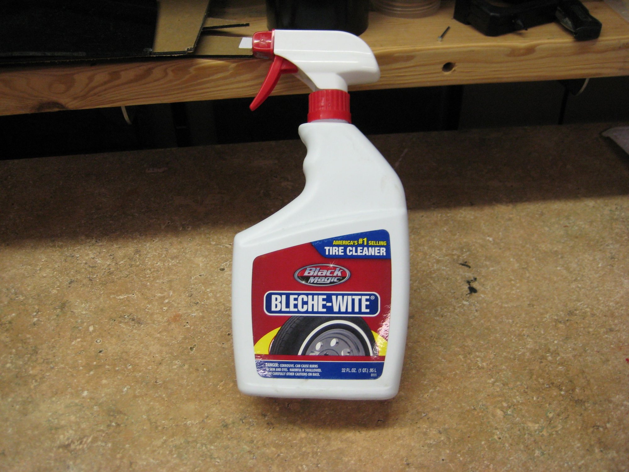

3. Has been talk here on cleaning the engine, I have found spraying (fine mist) some Bleche-Wite over the parts you want to clean (cold engine) let it set for 15 or so minutes and then using a sprayer (fine mist) with water works well, mine was dry the next day and was cleaner than I thought it would be !!!!

[QUOTE=akapounder;1591666571]I been working on my car and thought I would share some tid-bits !!!!
I also replaced the factory rubber lines with braided lines a couple months ago on my '97. I remember the clip that hold the connection in place was a b**** to get loose, but the fittings turned pretty easily and only took a moderate effort to break free.
The bolt that holds the brake line in place at the caliper was another story, I felt like I was going to snap the bolt trying to loosen it.

As a Dealer Tech for many years you find a easy way of doing a lot of things !!!!! The hose bolt at the caliper put your wrench on it at a good position and smack the wrench with a rubber hammer !!!!! The clip I took the bracket off the car with the line still attached and put it in a vise, easy-pesy !!!!
