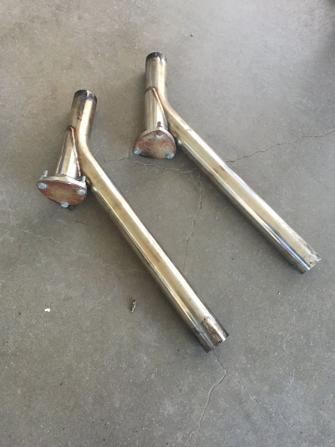

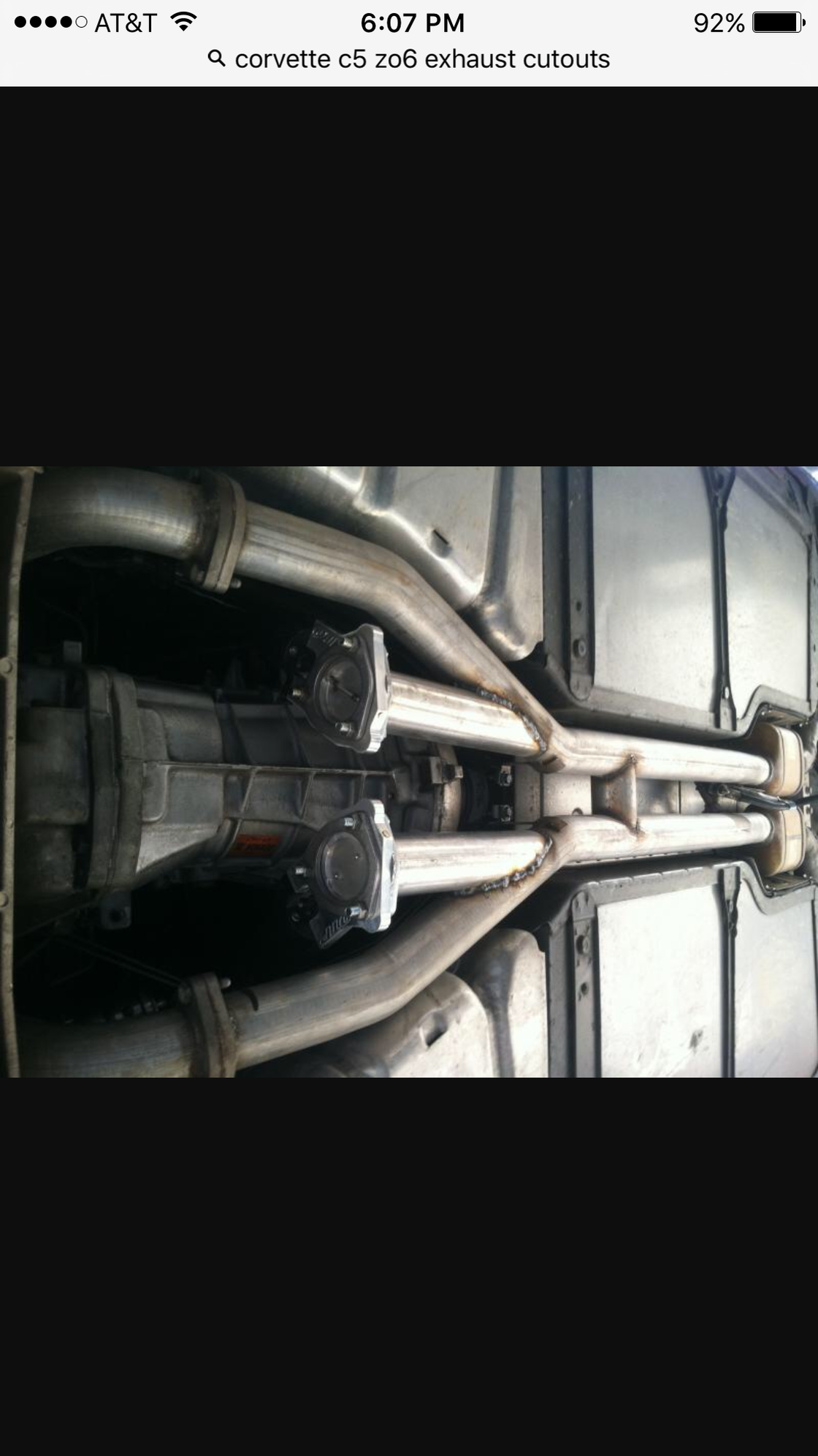

I got a great deal on some stainless 2.5 cutouts and I need to know if the entire exhaust system is Ti or just the back section with the mufflers is Ti...If it's steel up to the Ti muffler section then it will workout perfect for me thanks...

Aluminized steel up to the connection, then ti.

If you just plan on opening those cutouts you're looking for trouble...
You're exhaust is now aimed right at the rear spring and cutouts like that have been known to cause the rear spring to collapse due to the exhaust that is aimed right at the rear spring.
If you're going to use those you need to add enough tubing to get past the exhaust or you're going to smoke the rear fiberglass spring...

Thanks for the heads up guys I did turn down the hell out of them and I'm sure it's enough...I also barely drive the car and rarely drive it at high speeds...so I should be fine right? Just be careful when I actually do track it?
