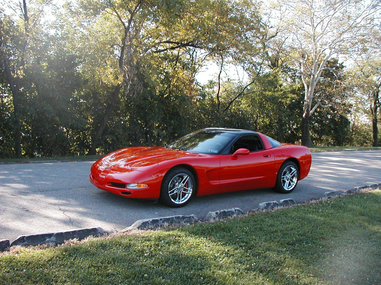

Nice car the wheels look great. GM had trouble with 2000 style thin spoked wheels and also had problems with the magnesium wheels forming cracks.
Point well taken. I am just betting that these will work well with the car and be as good (certainly functionally, aesthetics is open to personal opinion) as most any wheel out there. Why not at least consider OE type along with aftermarket.. ? It seems there are an infinite amount of mods out there but I guess I also feel that in a way, the C5 is a "classic" ...So I try to stay true to that vein; if that makes sense.. Just my opinion.
