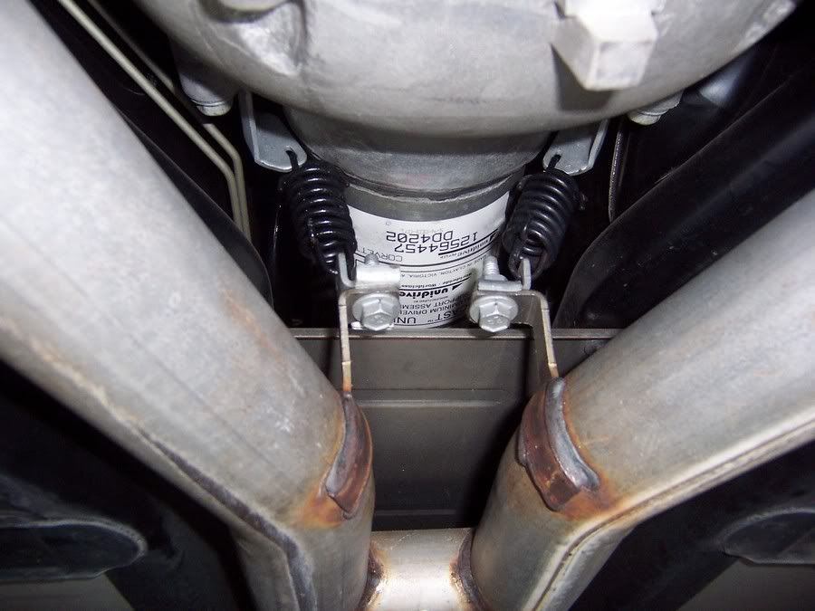

My money is on the front air dam.
the exhaust springs look like this.

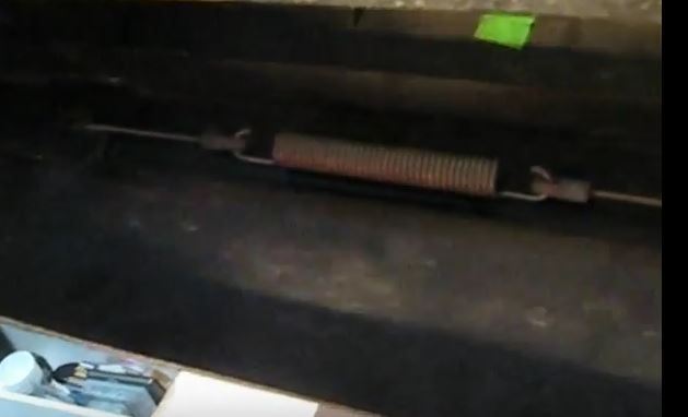

...and here is Froggy's video to help you with repair:
To Found this under the car...
