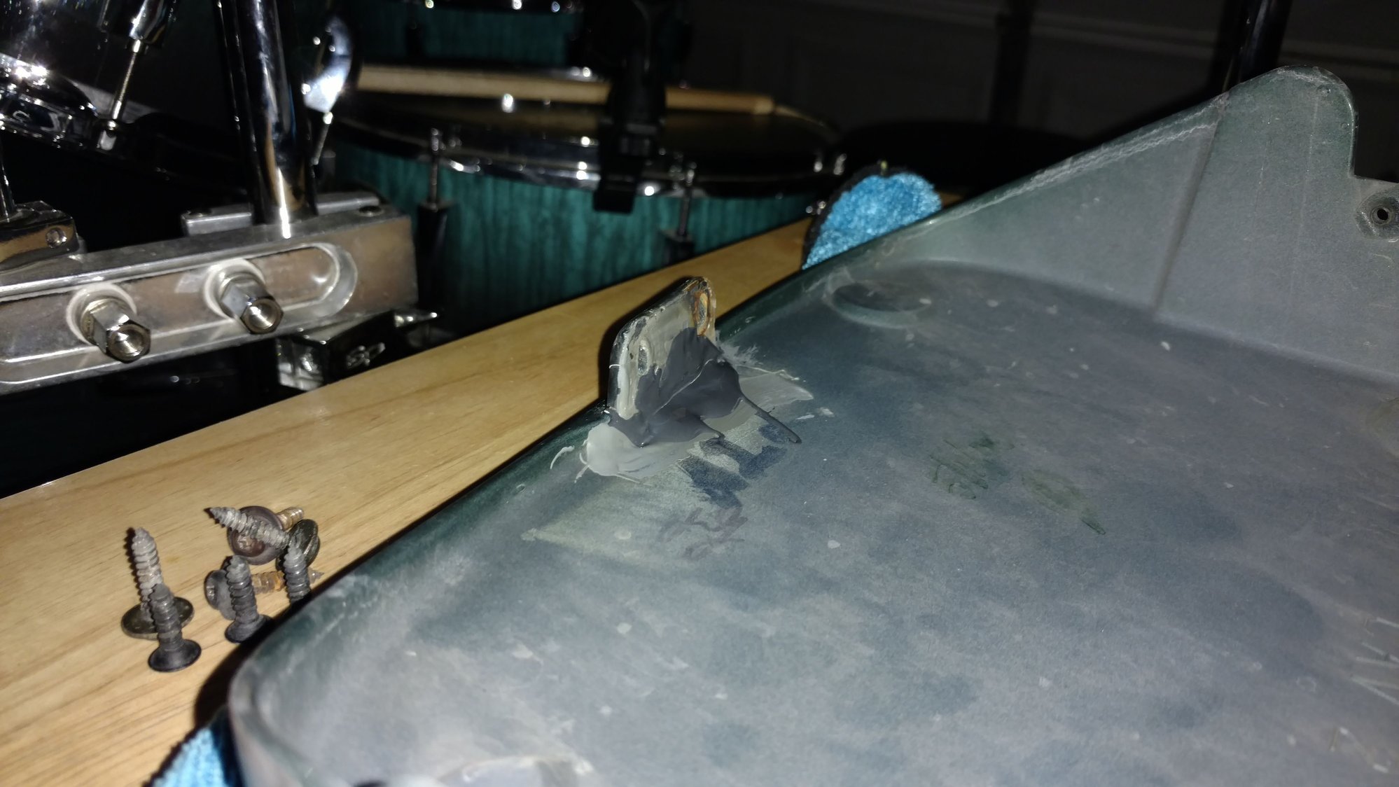

Hey guys,
My headlight cover broke in the back where it connects to the portion that is screwed into place. Here's a picture to help clarify where I'm talking about;
Is it ok to use superglue here to fix that? A friend of mine explained that he heard sometimes some super glues can melt the plastic that this part is made out of.
If super glue is not the appropriate way to fix this, what should I do? Buy a whole new headlight cover? (I'm hesitant to do that, there was an issue with the bowling green paints, they swapped the colors between 2000 and 2001 and kept the same paint code, so if I buy one that's sold as bowling green it may not match my paint...)
Thanks guys!

I don't know about superglue for such a thick part that is in a moving mechanism. Might want to look into stronger epoxy products like a jb weld clear weld quick setting epoxy. It dries strong and clear in about 5 mins.

I agree withe above post. Home Depot or the like have several 2 part epoxies. They make one for plastic that likely will be the best bet for your repair.

By itself the glue may not hold due to the small surface but if you made a small angle piece out of sheet metal then glued that in to hold it together after preparing the surfaces it will probably hold.

If you go to Home Depot, look for a product that is 2 parts. The "Primer part is a small pen that you rub on the areas to be joined. Then you use part 2, which is in a small bottle with a brush applicator. It works when a lot of stuff doesnt, and the best part imho is NO MESS ! !

The longer the setting time on the epoxy the stronger the bond.
Superglue, cyano will not melt that plastic, only foam. There is also a cyano which is foam safe but not applicable here.

Another point regarding CA glues: if you use them on anything you need to remain clear, beware that as they cure they offgas, and the fumes can create cloudy areas.

Newer lids of the later model C5's have been slightly redesigned with small, right angle gusting on that tab. My 2002 has them. A '99 lid I've repaired does not.
Try to ensure the tab is relocated at the same angle it was when unbroken. If glued at a different angle this could prevent it from fitting at all (unlikely) or (more likely) that if reattached at too wide/open of an angle then when tightening it you could crack the repair or even re-break it if reattached without cloth backing or re-enforcement of any kind.
Two part epoxy and some fiberglass, carbon fiber cloth, old t-shirt, drip coffee filter, etc... laid inside the angle for strength did just fine for the lid I purchased cracked (it was inexpensive cracked and I needed it for headlight fitment projects) and then repaired. Re-drill the mount holes and gtg.
If inclined, fab up the right angle metal re-enforcing suggested earlier in this thread and use that as an angle guide by fitting it to the good side for shape, then using it with spring or c-clamps to hold the epoxy and cloth in the right aspect until dry.
If more inclined use a heat gun on low or hair dryer to cure the epoxy while under clamps for an even more durable repair. With a little bit of car wax applied to the metal it will separate from the repair easily when unclamped...
...or just JB Weld it.

Currently letting the JB weld set and cure Took me long enough to get around to it lol

Here is a trick I use to make a bond bullet proof
Use a two part epoxy ( the trick ).. go to a auto store or automotive paint store and get a piece of fiber glass mesh.. cut some fibers from it then mix the two part epoxy in a small cup, add the fiberglass fibers, to make a thick past and fill in the area.. allow it to cure, then sand and paint and it will be stronger than the original sub straight.

The fibers reinforce the bond from every angle... This is the same principle used in making your glass filled nylon intake manifold... its made with glass filled fibers for strength. it also took 25 lbs. out of the car.
the fiberglass fibers acts like re-bar in a construction cement pour.
Just use a scissor and chop up the fibers into small pile, making the fibers about 1/2 in long. they will bend and inter lock, and while the epoxy is fluid, you can mold the past into any shape, or fill any opening.
