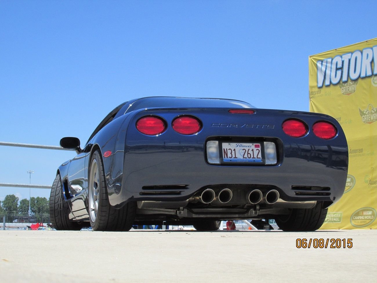

I had it somewhat fixed but the exhaust tips were tilted at a slight downward angle.....
You guys with Corsa Xtremes, are your tip pointing straight out or tilted ??

mine are straight....

Mine are straight and don't hit anything
