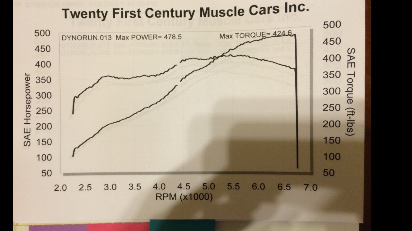

Good street manners will be different for everyone. What i think is good streetable cam you might think its not. Also why do you want 1 7/8 headers? For a N/A motor 1 3/4 will be perfect. Do you plan on doing FI in the future? All that being said My cam is 238/240 605/609 112 lsa. with 1 3/4 LG super pros no cats, ported TB, UD pulley, airaid intake and a great tune. Car made 478rwhp and 426rwtq. I daily drove it for about 8 months with no problems.

Well my prior car was an '06 Evo IX with 501whp so honestly to me, the Corvette feels like a Cadillac at the moment, lol. I went with the 1 7/8's since I found them with the Xpipe for $900 lightly used, decent deal? I'm just more concerned about having minimal low-rpm bucking, being okay with stop-go driving. Stock c5z clutch I assume will be done soon at higher power levels. You have stock Ti on as well? I'm also reading about how tough some cams are on valve springs...thanks also for your input!
You made those numbers with stock ls6 heads?
Yes sir. I don't know how or why, but it did.
