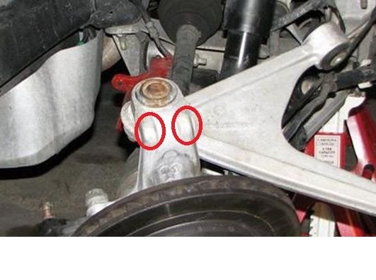

i was a little worried about the grinding on the rear to fit 16" rims but i winded up doing it, didnt take much to get them to fit probably took less then 1/8 of an inch off. i was told running a 16" bias ply would be softer on the drive train (more side wall) then a 17"
slick sway with the bias ply in the rear and radial tires up front was a little scary on the big ends so for the front i'm using GTO spares with 1.5" adapters to convert from 5x120.65 to 5x120 and M&H bias ply front runners, over all coast for the setup was way less then the drag pack's
i daily drive the car with my street wheels no problems
in this pic you can see the two humps that need to be hit with a grinder

That is all I would have to grind to make them fit? That is actually not as bad as I thought, but I still will likely use a 17" inch wheel. If I can find a set of the "wagon" wheels from an older C5 or a set of 17's from a Trans Am or Z28/SS. I won't be driving the car on the wheels and will just be putting them on then taking them off before leaving the track.
