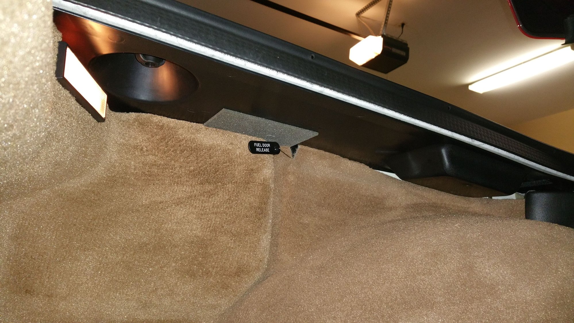

The fuel door does not work with the button! Is there a solenoid that operates it, and if so where is it at and how do you get to it?

There is a thin cable inside the car near where the fuel door is that will open the door when the button doesn't do it.

There is a release actuator and as stated above a manual release cable located behind the drivers side rear wheelhouse carpet.

A little behind the driver's side rear wheel.
