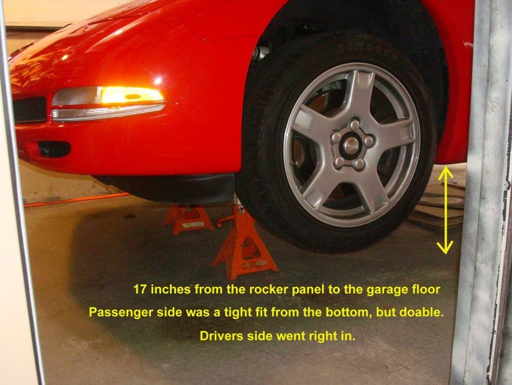

The Vararam just have patience, the headers you should have the car up around 21 inches off the ground
You can stack 2x8 's or 10's to get car up !!! drive up on them !!!

First tip i have is get the car high...very high. I used some blocks of wood to jack the car high enough to slide the driver header in from the bottom...(LG super pro)
second is to remove the coil packs to ease in your hands while starting the bolts.
Third and these steps are obviously optional LOL
i like to remove my fuel line (driver side) so that i can reach the back bolt easier.
hope this helps. Good luck!

I did a few installs of XSPower headers with the above height. Extra height wont hurt.
