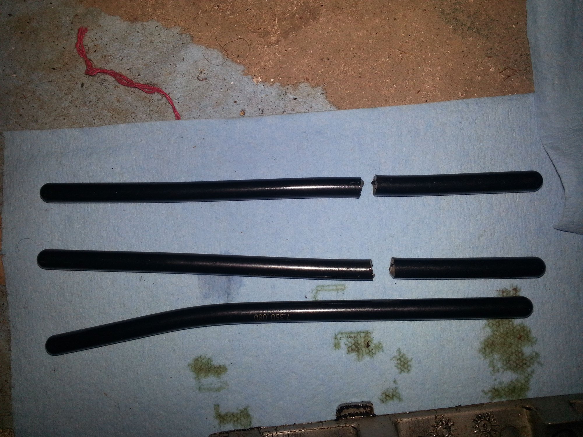

Old May 15, 2016 | 07:56 AM
appliance guy's Avatar
appliance guy
Joined: Dec 2015
Posts: 156
Likes: 8
From: Florence South Carolina
Build update..
Moral to the story, MAKE SURE you set timing right the FIRST time!
Broke and bent several pushrods, bent the valves. ..
Off with the heads again, for the 3rd time ugggghhhh !

Old May 15, 2016 | 04:43 PM

Old May 15, 2016 | 05:33 PM
appliance guy
Joined: Dec 2015
Posts: 156
Likes: 8
All exhaust valves bent
12 out of 16 bent or broken
