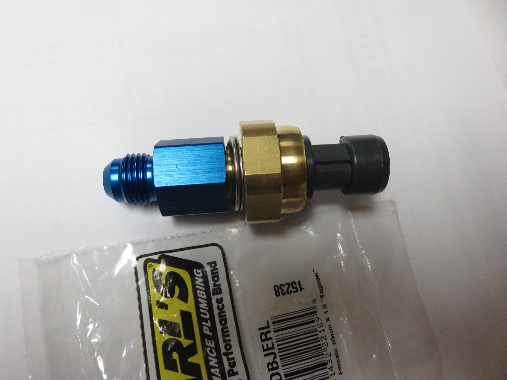

I am going to attempt to repair the EBCM, code C1214, and at the same time I will be pulling the intake on my "new" 2002 to do the oil switch and put in the relocate.
I purchased the suggested fittings for the relocate but when I screw the switch into the adapter it bottoms out in the fitting and the gasket does not 'crush'.
Any one come across this before?
Thanks,
Joe

Originally Posted by akapounder
these are the parts I used and how I installed them (download Doc.)
Thanks for the docs.
The male threads on the switch are 16mm x 1.5 and the 90 degree fitting from Amazon is 3/8 female pipe thread, theoretically they are not compatible.
I assume you had no problem with leakage?
I stock that 90 degree fitting in my store and I make my own hydraulic hoses. I will check it out tomorrow.
Thanks,
Joe
Thanks,
Joe
nope !!! I used the supplied gasket and checked the fitment before in stalling it !!!! about 9000 miles and no issues and of course if there was I can see it plainly !!!!!
