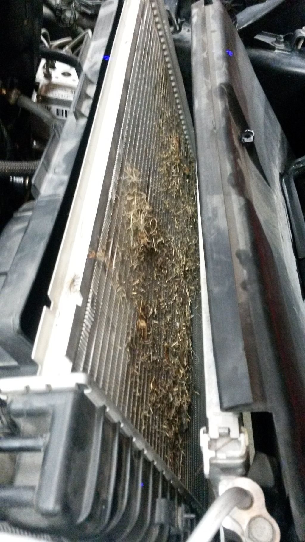

I finally followed some advise I picked up on from this forum. I couldn't believe the amount and kind of trash on the front of my radiator. This pile was removed from the front side my using only my hand.

Originally Posted by 8VETTE7
Probably still a lot more lodged in the cooling fins. I would personally pull the radiator and use a garden hose on the back side towards the side that had all the debris. Bet there will be lots more sand and dirt that is preventing maximum cooling...........
Is there a way to get to the backside without pulling the radiator?

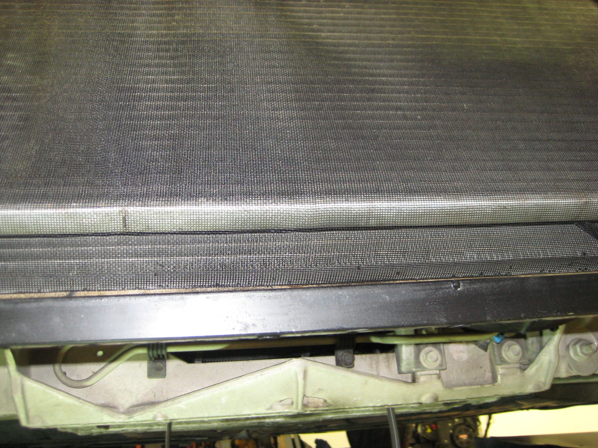

i installed this radiator screen from Elite Engineering about 5 years ago. One of my best mods in terms of performance as I added it the same time I installed my Callaway Honker CAI which is basically a super, bottom sucking, road vacuum, and my radiator support Fangs.
I've seen other guys use gutter guard or other screening material available at any hardware store if you want an economical solution.
I had that same setup before I installed the Maggie and it definitely keeps the big "chunks" off the radiator fins but doesn't help much with sand and fine dirt....
Correct. Living on the west coast of Florida, I do suck up a lot of road sand into the engine bay, especially during my beach side drives. I also find it funny how many leaves, plastic cups, wrappers, etc., fall down onto my garage floor after I park the car.

Radiators should be blown out regularly, what the OP showed is a VERY small fraction of what's in his radiator.
These cars are vacuum cleaners in the literal sense. I get as much out of my car on a monthly blowout as the OP posted. I pulled and cleaned mine initially and was shocked at what came out of the fins. It no longer runs hot on track though.
Pull the intake off and pull the top radiator cover off. You will need a wand and air pressure to be effective.
Needs to be pulled and cleaned if it has never been done, blowing it out is maintenance.

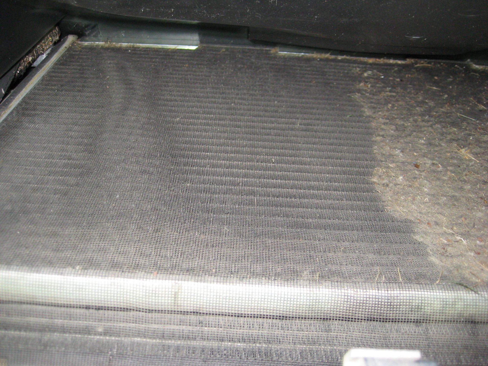

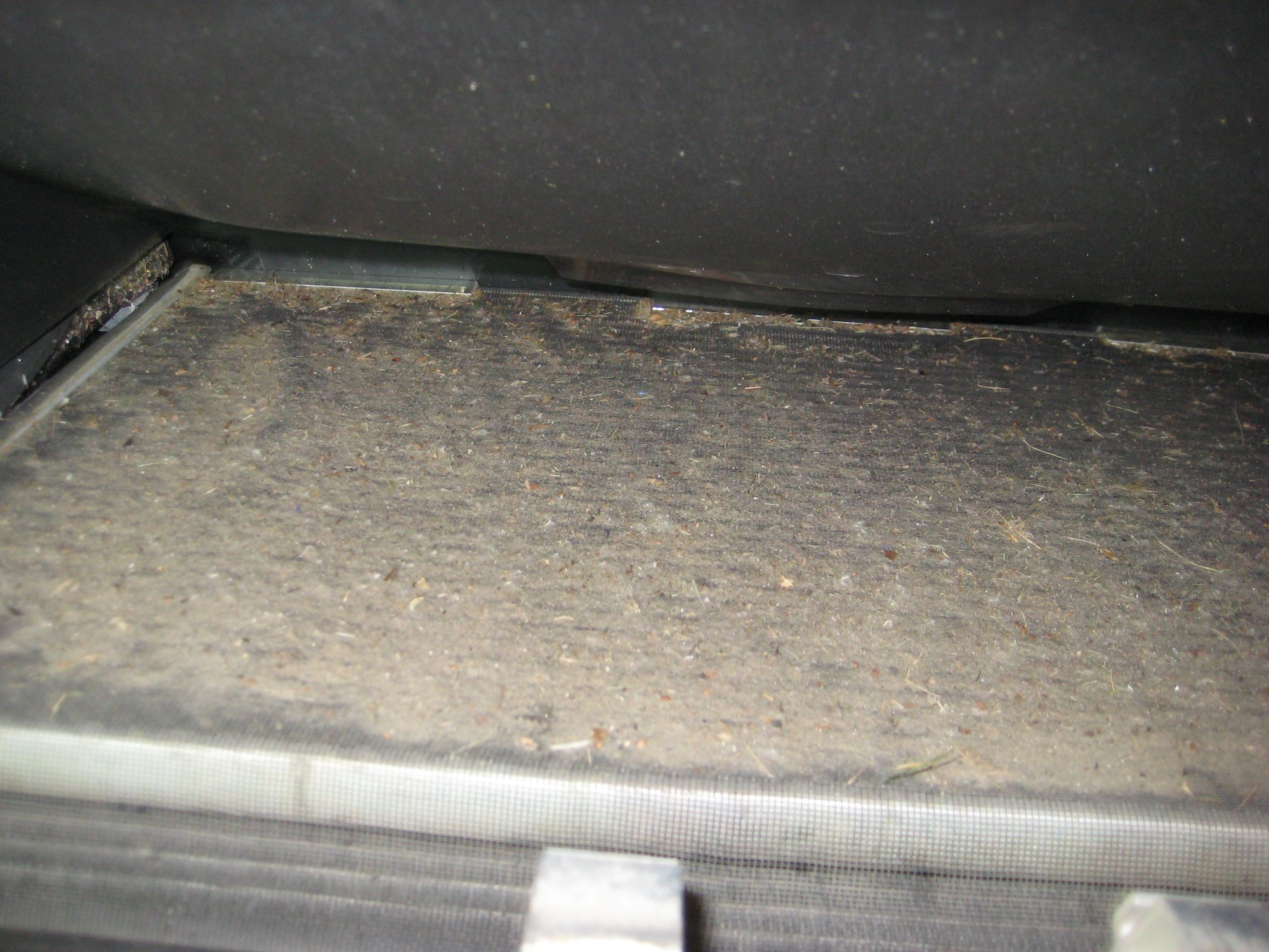

Here is mine, 2003 and never been cleaned. Ran hot almost immediately on track.
This was a week of driving AFTER I cleaned it. This is actually the a/c condenser.
