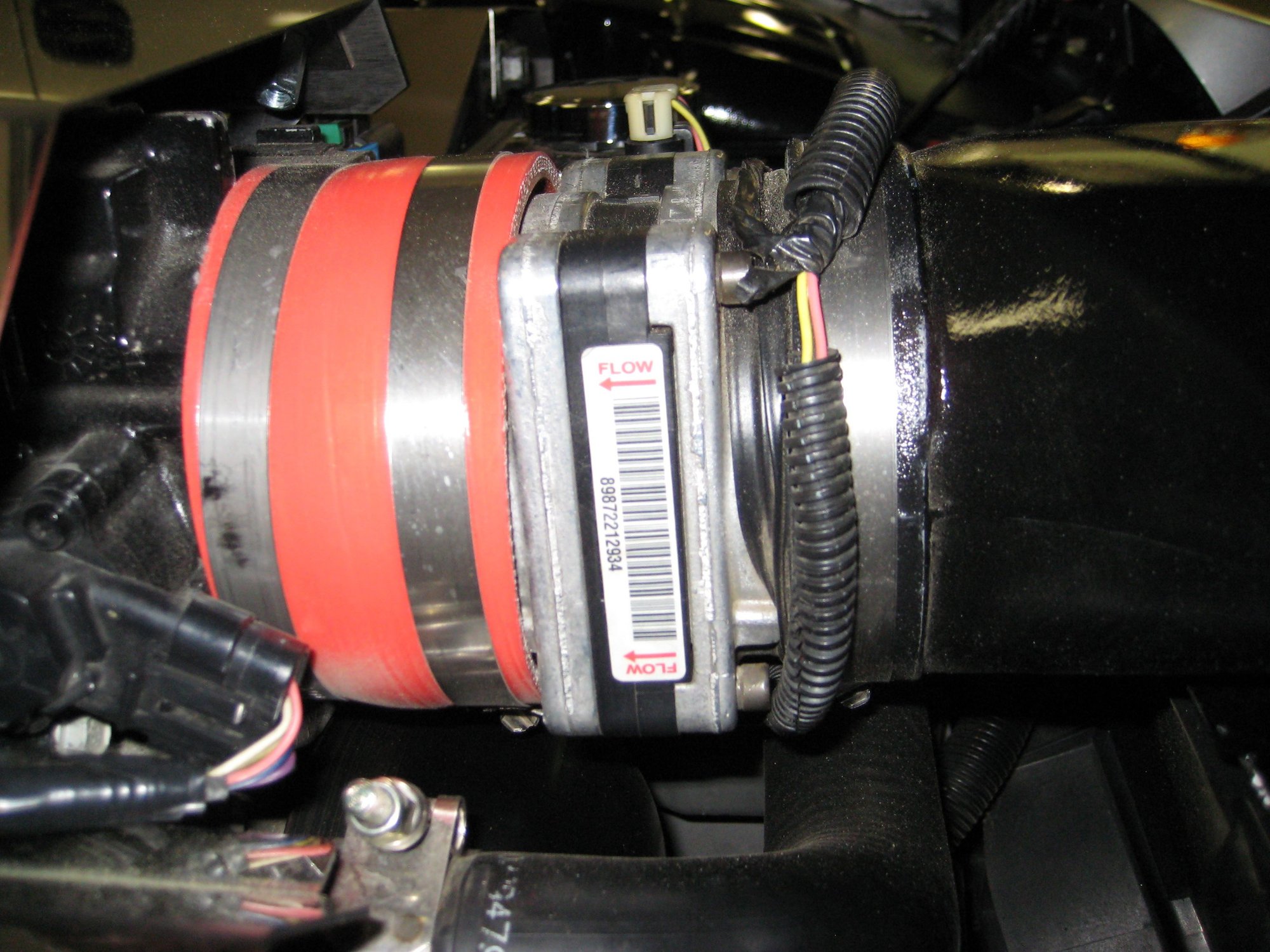

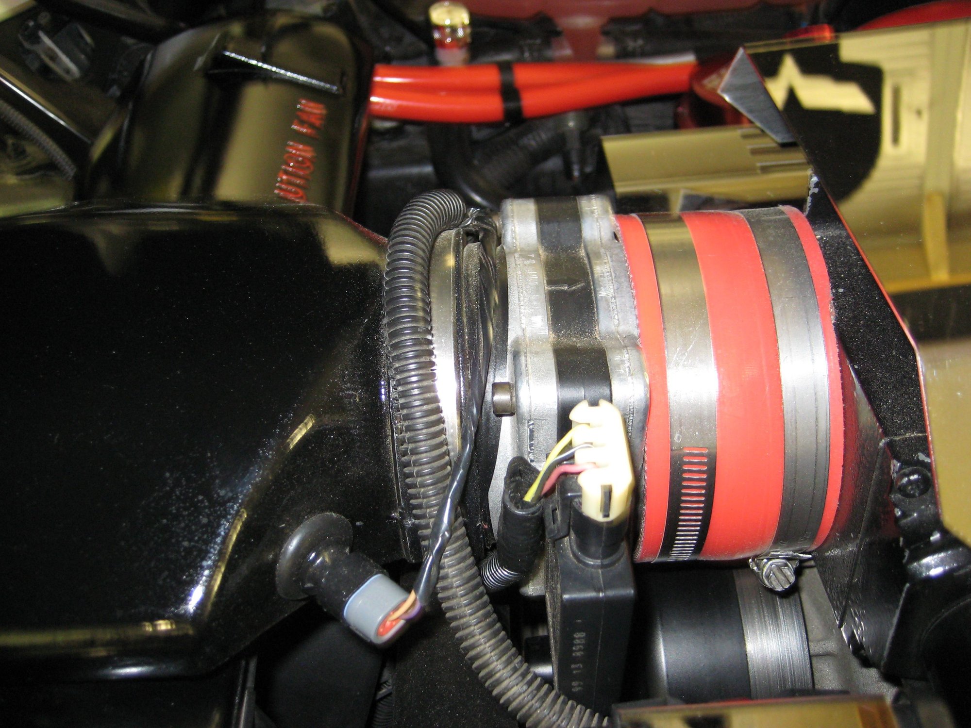

I moved my Map sensor next to the throttle body and made the coupler as short as I could at the throttle body (this was a redo because of hood rubbing) I have no more issues !!!

Most couplers going from the 3 1/2 to 4 inch required take up a lot of room (length) so I cut a 3 1/2 down to the narrow part of the throttle body and then just ran the 4 inch over that to take as little room as I could. (the power duct seems to fit the best to get it close to the throttle body( remember I have my MAP sensor next to the throttle body) the on the filter side of the power duct I used what ever length was needed.

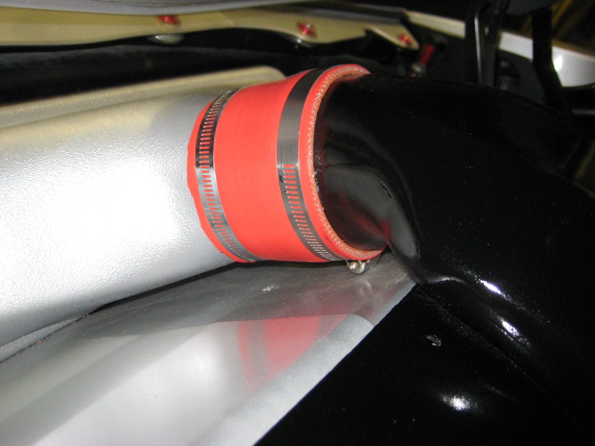

I had to add a cut in the silicone coupler - my attempt was so-so but ECS cleaned it up while I had it there...

I watched a install video on you tube and they said some found better driveability with the MAP moved next to the throttle body. I just thought it was a cleaner install, not sure if I bought extra parts (don't think so). I just have a lot of that stuff around from working on other cars. Also told Doug at ECS that my MAP was moved so he could adjust my tune accordingly !!!!
