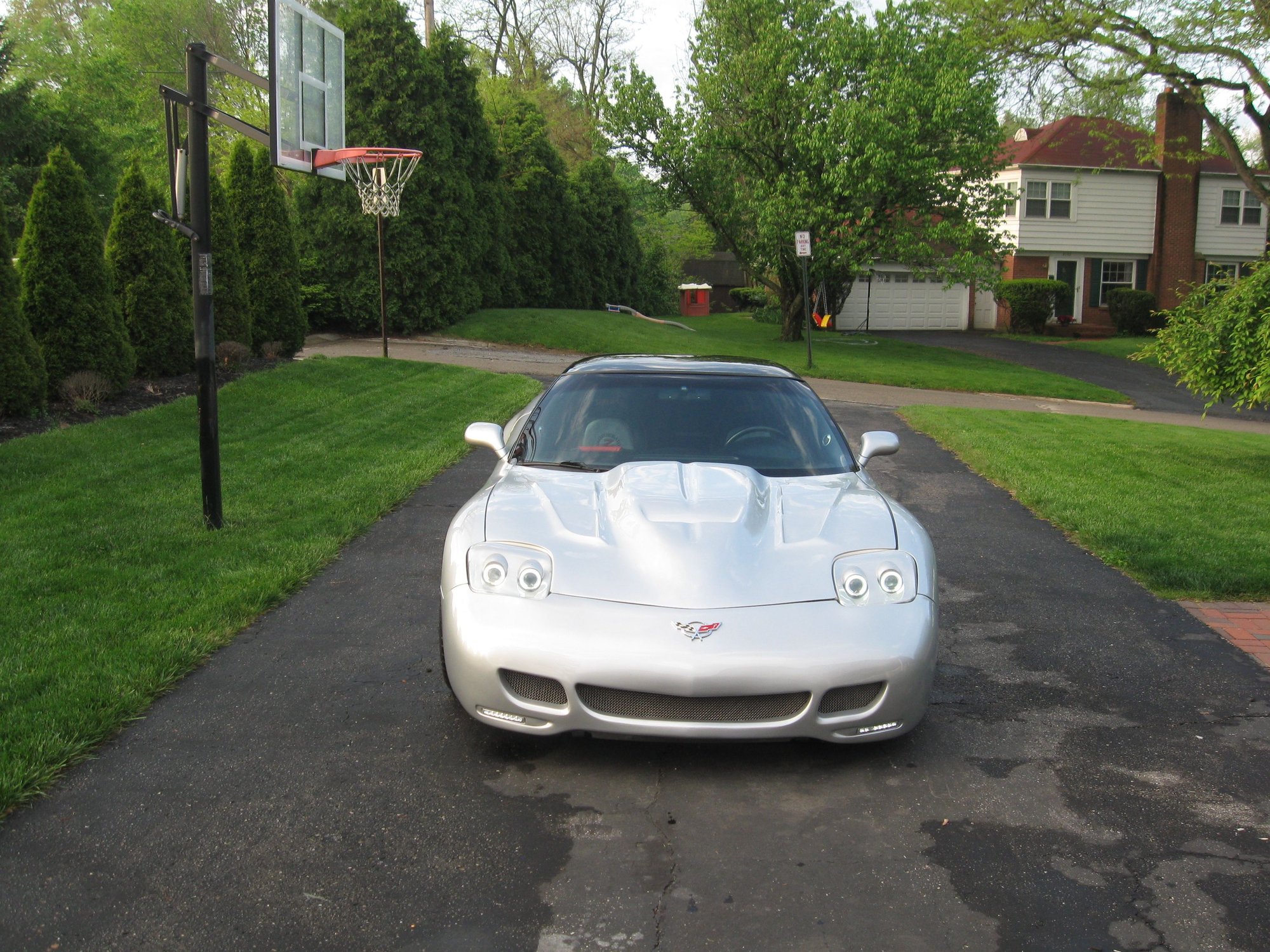

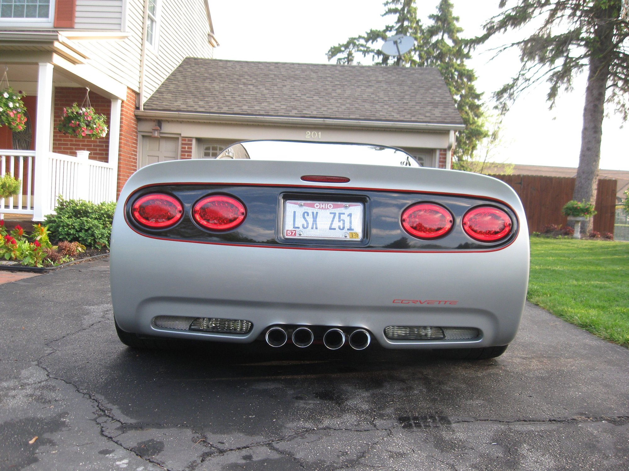

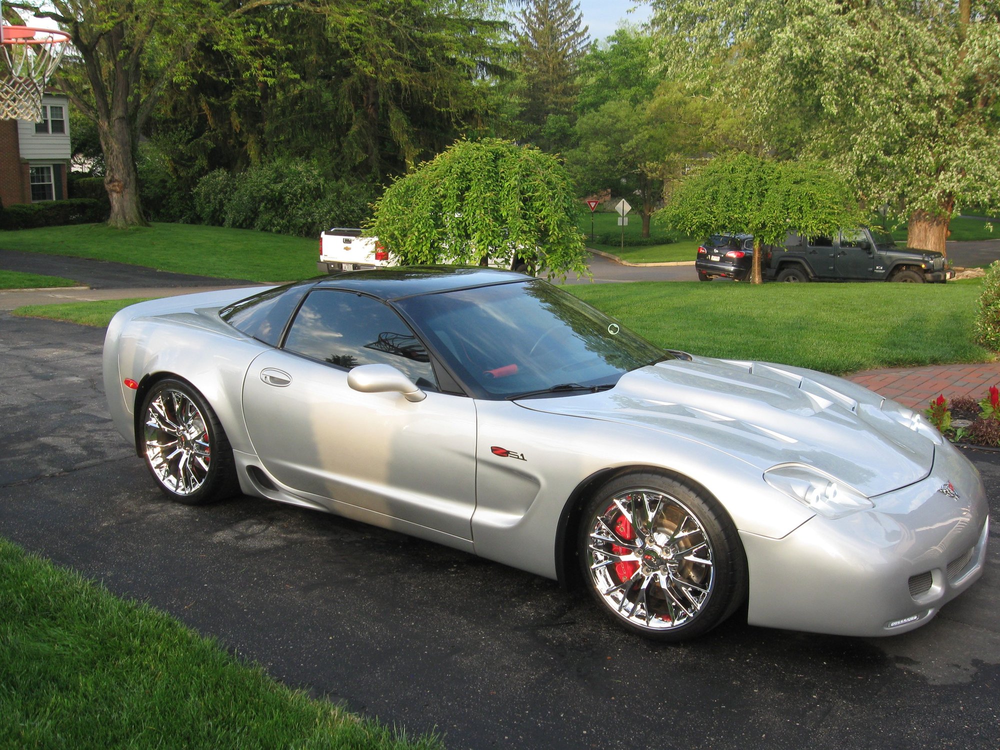

I have the tiger shark 2 front bumper with a supercharger and my temps run around 200-210 on the 90+ days, I also have a tiger shark rear bumper. Here is a few pictures of my tiger shark bumpers.

Originally Posted by nzcars33
That's an exceptionally creative solution for the lack of reverse light issue that TS rear fascia owners have to deal with. Further emphasized by you still having a vented portion for the mufflers.

Thank you, I used the reverse lights off a C6 and cut screens that fill the bumper openings, this was to allow air flow over the mufflers so that the heat doesn't warp the bumper cover, it works well and looks very good in my opinion.
