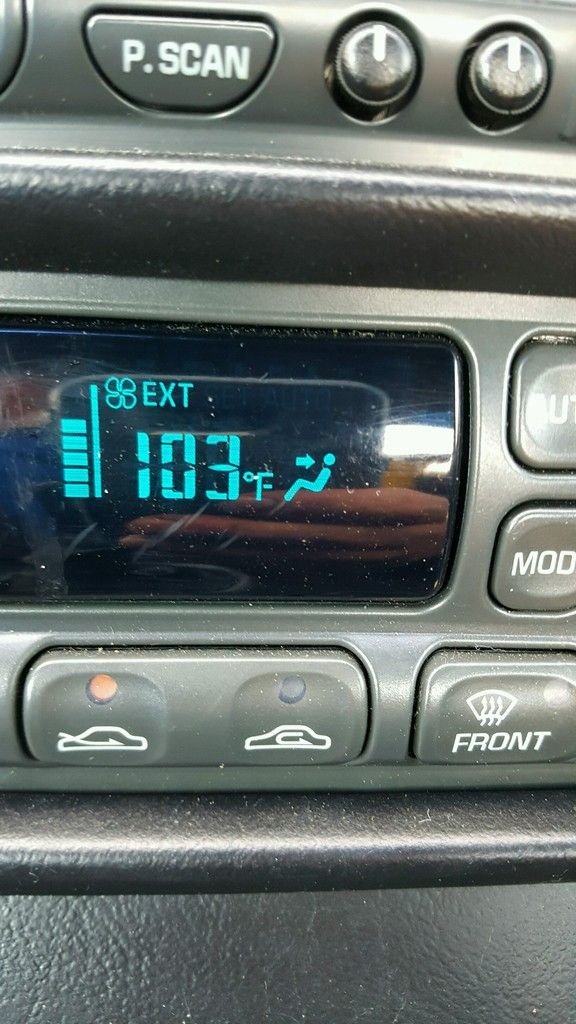

Drove mine home the other day from work...55 miles one way...on the interstate...
My Temp....
