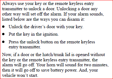

The only thing I can think of is the trunk. It does not open well (need air pressure to pop it enough to get a finger under it) and it does not close so hot either. I have seen the trunk open warning when I thought it was closed. On incident #1, I had just popped the trunk (no alarm) shut it (but maybe not entirely) then opened the door. ALARM. Today the dang thing went off (in the garage-not locked) and after shutting down the alarm, starting the car and backing up I got the Trunk Open warning again. Maybe that's it? The manual is not real clear but does state:

Originally Posted by RoninC5
No They were not and here is the weird thing- It just happened to me again in my garage. I (Previously) tried to disarm everything through the DIC and you can't really. You can select horn or lights or both. I pulled off the cover (car had sat for 24 hours maybe) opened the door and BANG. Push all sorts of stuff and it stops. I think the door unlock is the one to push. And perhaps just hitting door unlock before I open a door will disarm anything activated but the door was not locked.
I haven't read everything here but I get the jist.
If you "lock" the car with the fob and your driver door for whatever reason (electrical obviously) doesn't lock, you'll set off the alarm when opening the if unlock wasn't used on your fob.
Wife and I went for dinner, locked and armed as always, we get to the car and I needed to go in the trunk for a second, before I could unlock it with the fob. Wife opened her door and Alex went off.
Short in the door somewhere causing her side to not work on occasion
