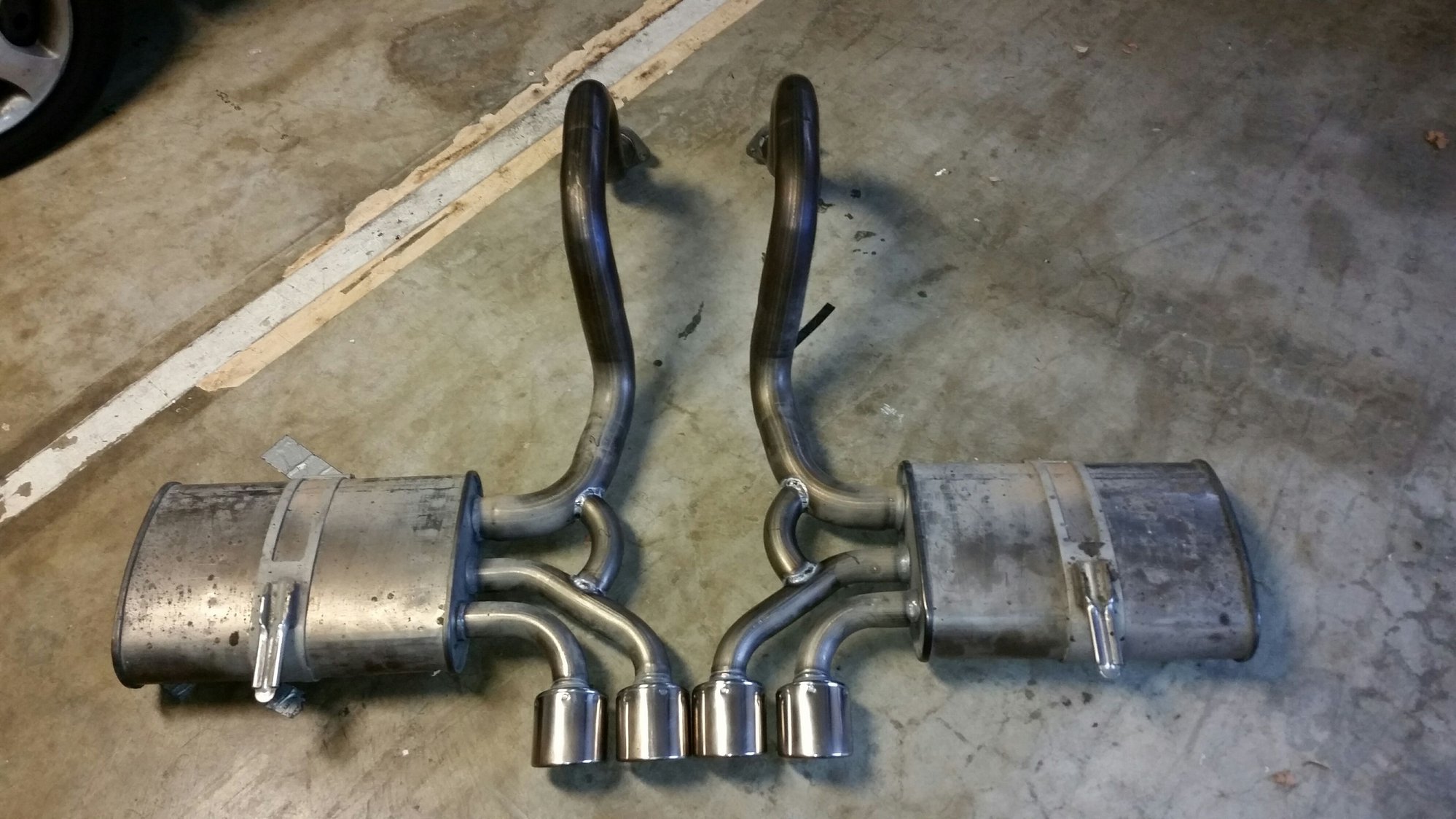

You can buy used C5 ZO6 Titanium cat-backs for 3 to $400.00. There is usually a set for sale here on the forum, or will be from time to time. Guys take them off their Z's, looking for 'more' sound.
They are Titanium, will never rust out, sound better than stock, and they weigh Less than 1/2 what the stock cat-backs do. You can also do what's called the Ti-Mod to them (which I've done, and love) which will open up the sound a little more, especially under heavy throttle. Some say they flow a little more air too, not sure about that.?.
But later, you can always sell them to someone else, and probably get all your money back (minus shipping) if you want something different.
The weight savings with the Ti's is substantial, and worth considering.
This is one option you can consider. Good luck.

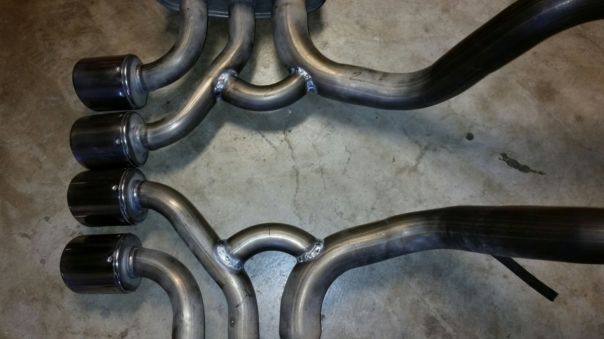

Originally Posted by Charles 1959
what is ti mod?
Ti=Titanium. Mod shown above, welding in the small bypass pipe into the exhaust. Allows some of the exhaust gas to exit directly.
