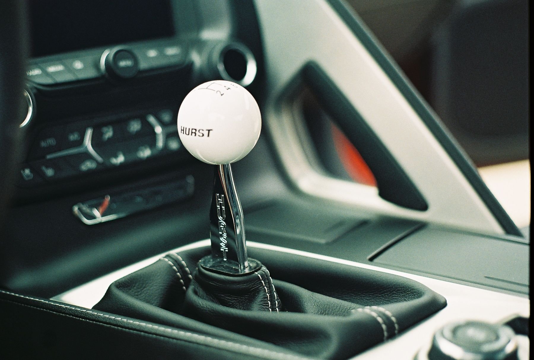

Originally Posted by Impulsive goat
I have the c6 upper half but I may just go all in on an MGW. Just curious how much does the c6 upper half sell for?
What about just buying the lower MGW box, and use the C6 upper shifter?
If the MGW will fit on a stock lower box, I would think that the lower box would work with any upper shifter.
I personally went with the retro look and feel of the CoreShifters Hurst.
Old Jun 24, 2016 | 01:17 PM
Impulsive goat's Avatar
Impulsive goat
Joined: Apr 2014
Posts: 346
Likes: 7
From: Jacksonville N.C.
That is beautiful. Good point on just the lower half I'll send an email out to MGW. thanks for the advice.
