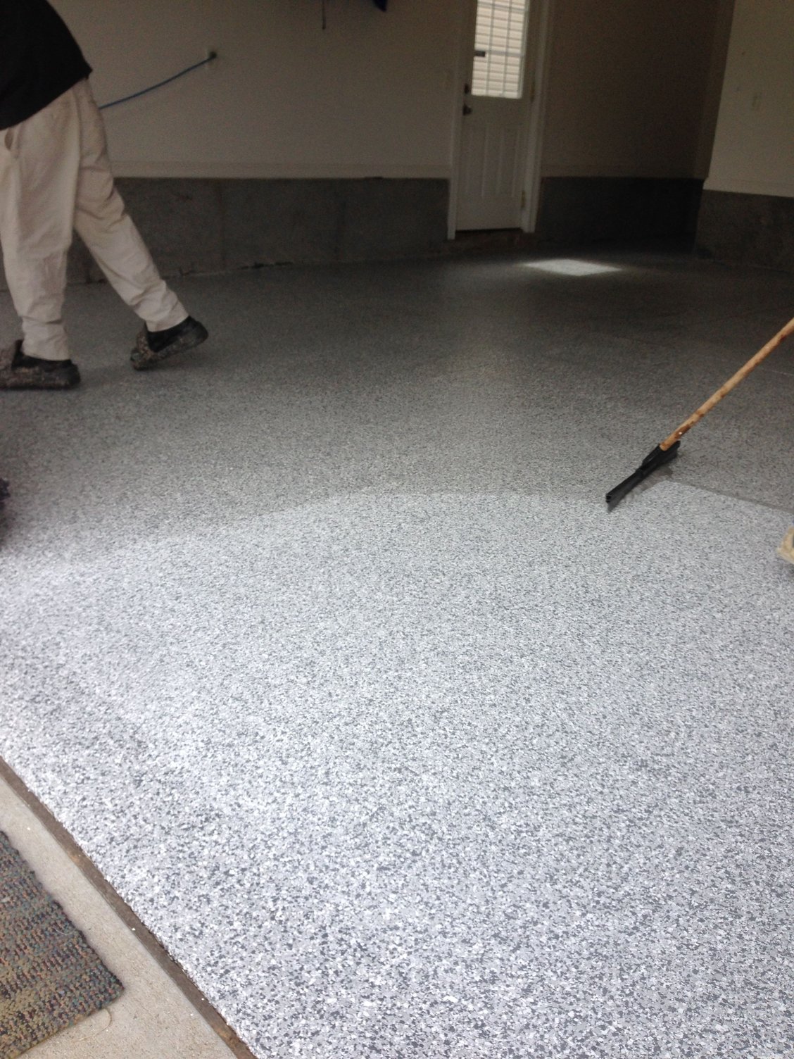

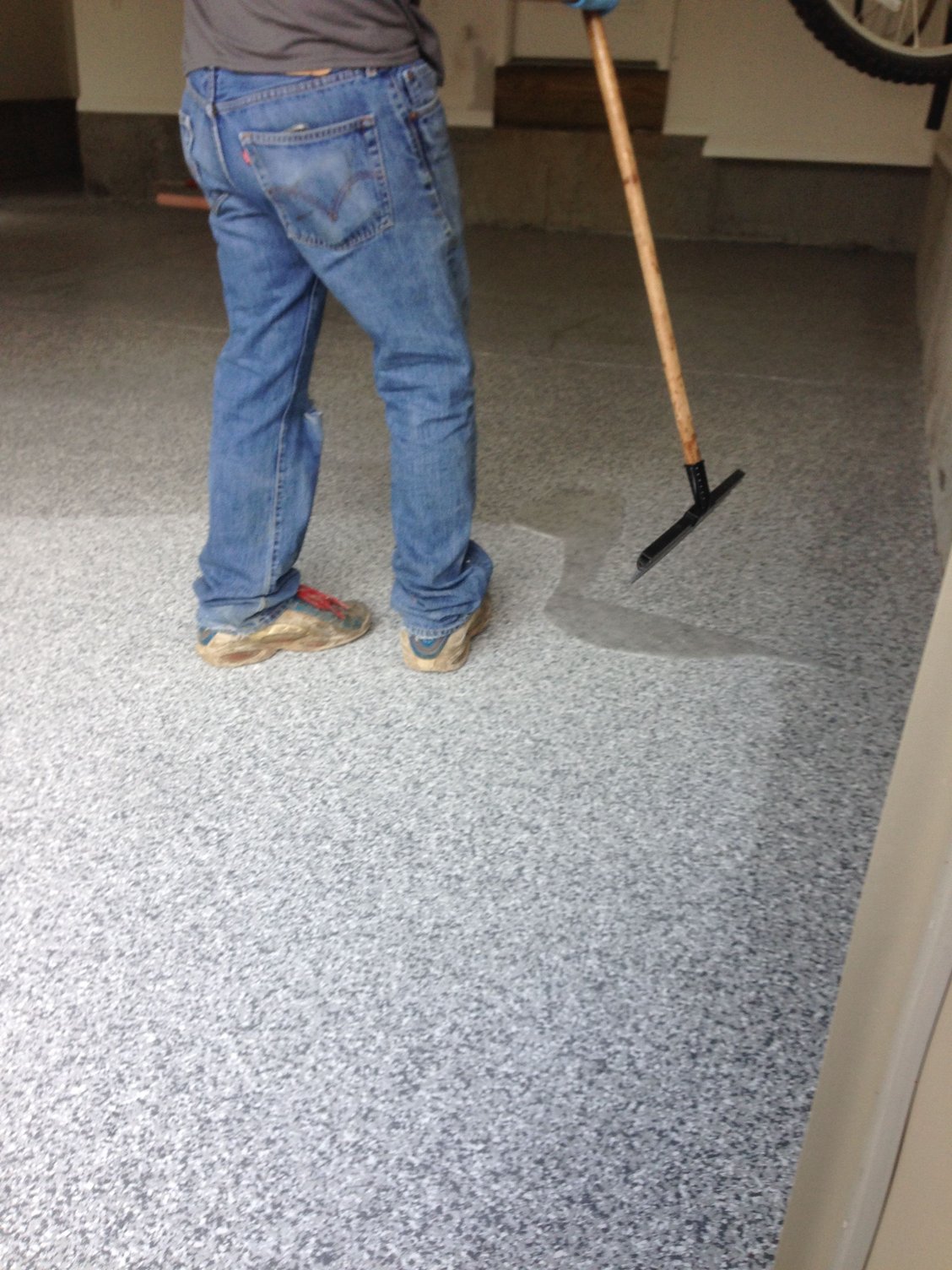

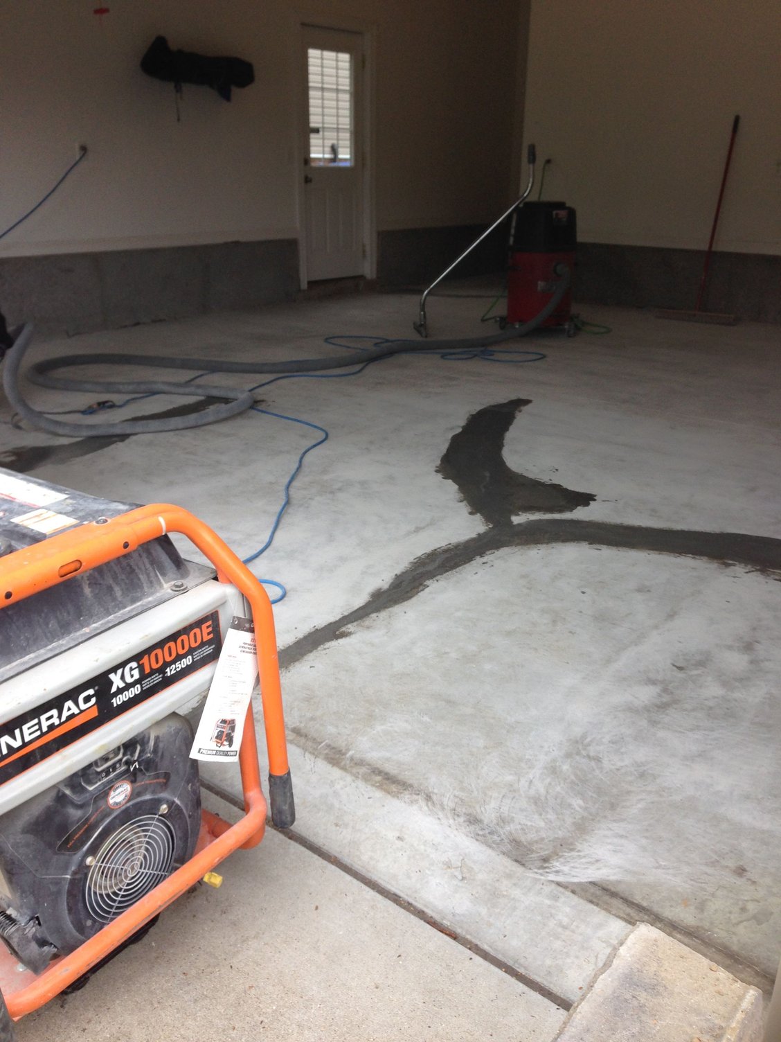

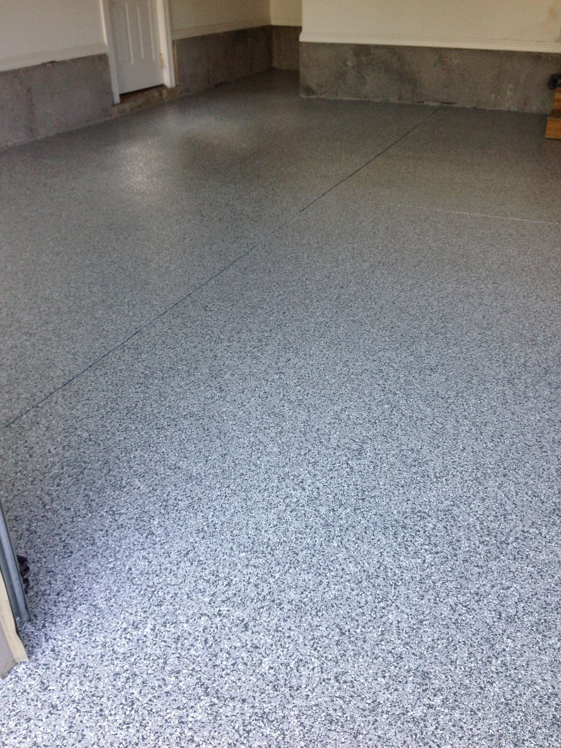

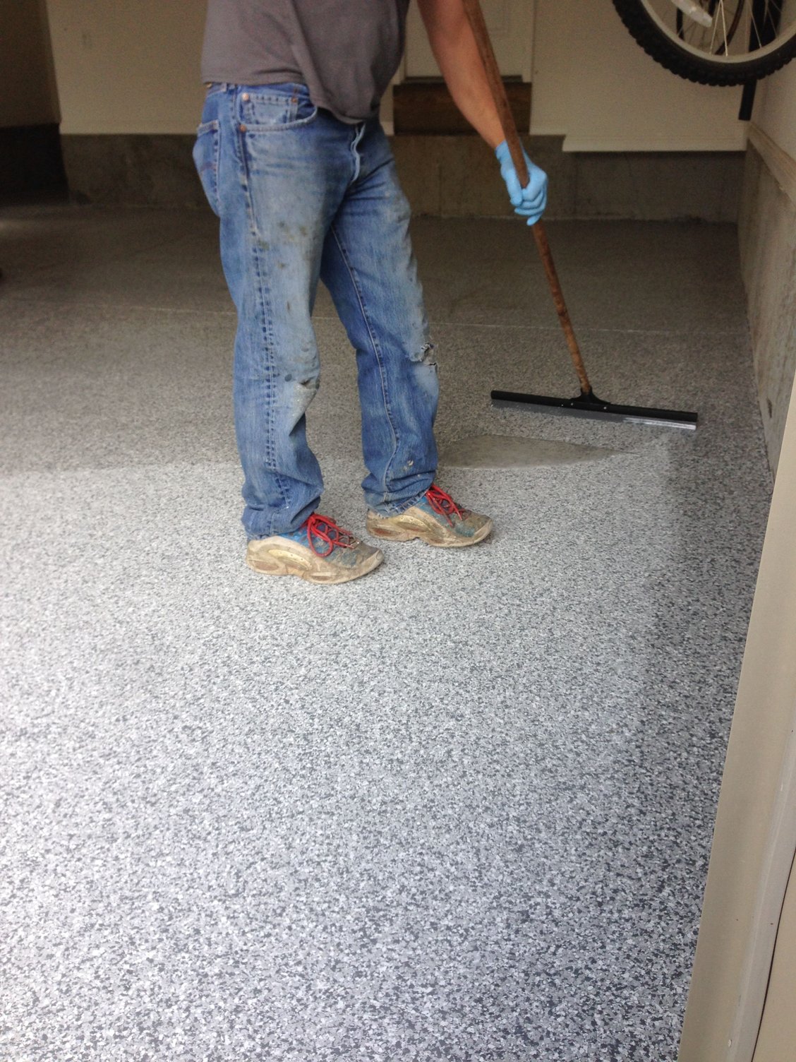

This floor is about 10 years old and had never had a finish applied. After going over the floor with a diamond grinder to give the surface grip, all the small cracks were opened up with a grinder and then filled with a fine sand and epoxy mixture.<br ><br > After a few hours the excess chips were vacuumed and scraped up. Then a clear epoxy was mixed and spread.<br ><br > <br > Once the cracks were filled an epoxy color coat was applied and then the color chips spread.<br ><br > After about 36 hours the floor was ready for heavy traffic. Lifetime warranty, we'll see!<br ><br>
My sons garage done back in May. Looks great and only took about 7 hours start to finish. Expensive but if it holds up it will be a good investment.
Sorry that the pics not in the best order!

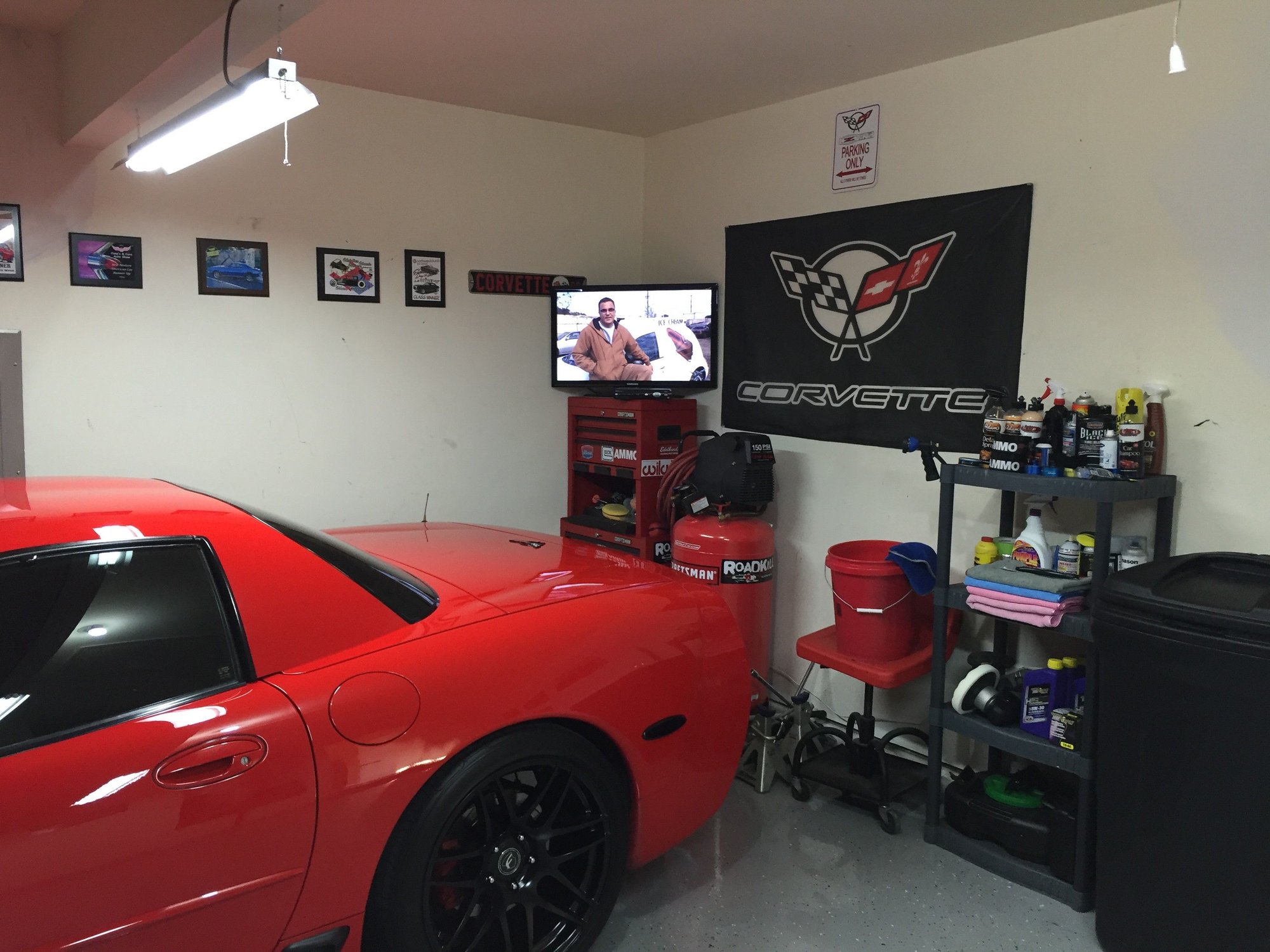

I did the Rustoleum Pro epoxy shield. These are bad pics but here they are. I did it about a year ago when i moved in and still holding up great. Its one coat of the epoxy and chips and one coat of the clear. I did mess up a few spots where i didn't cover it all with the clear with i have since fixed it.

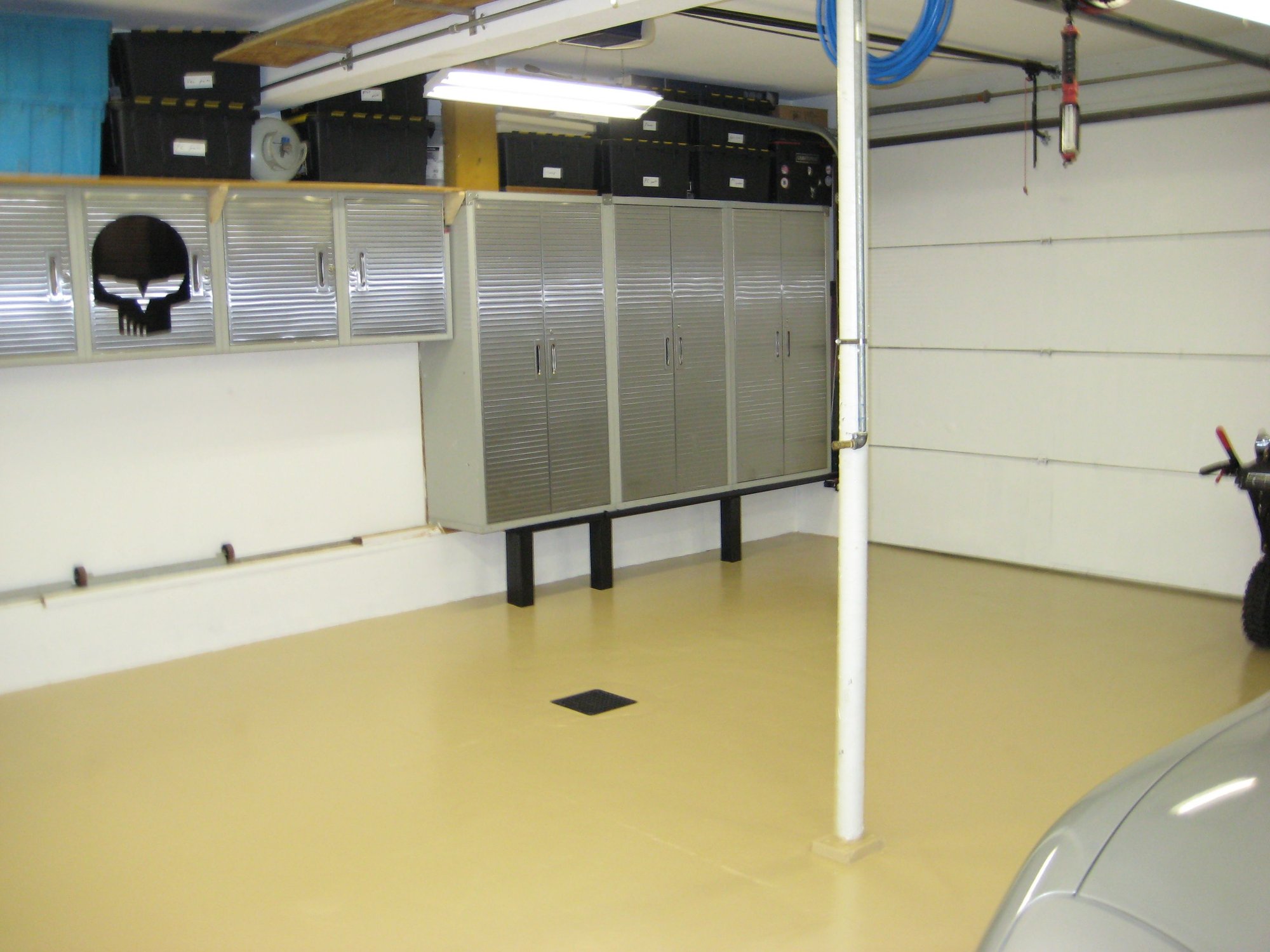

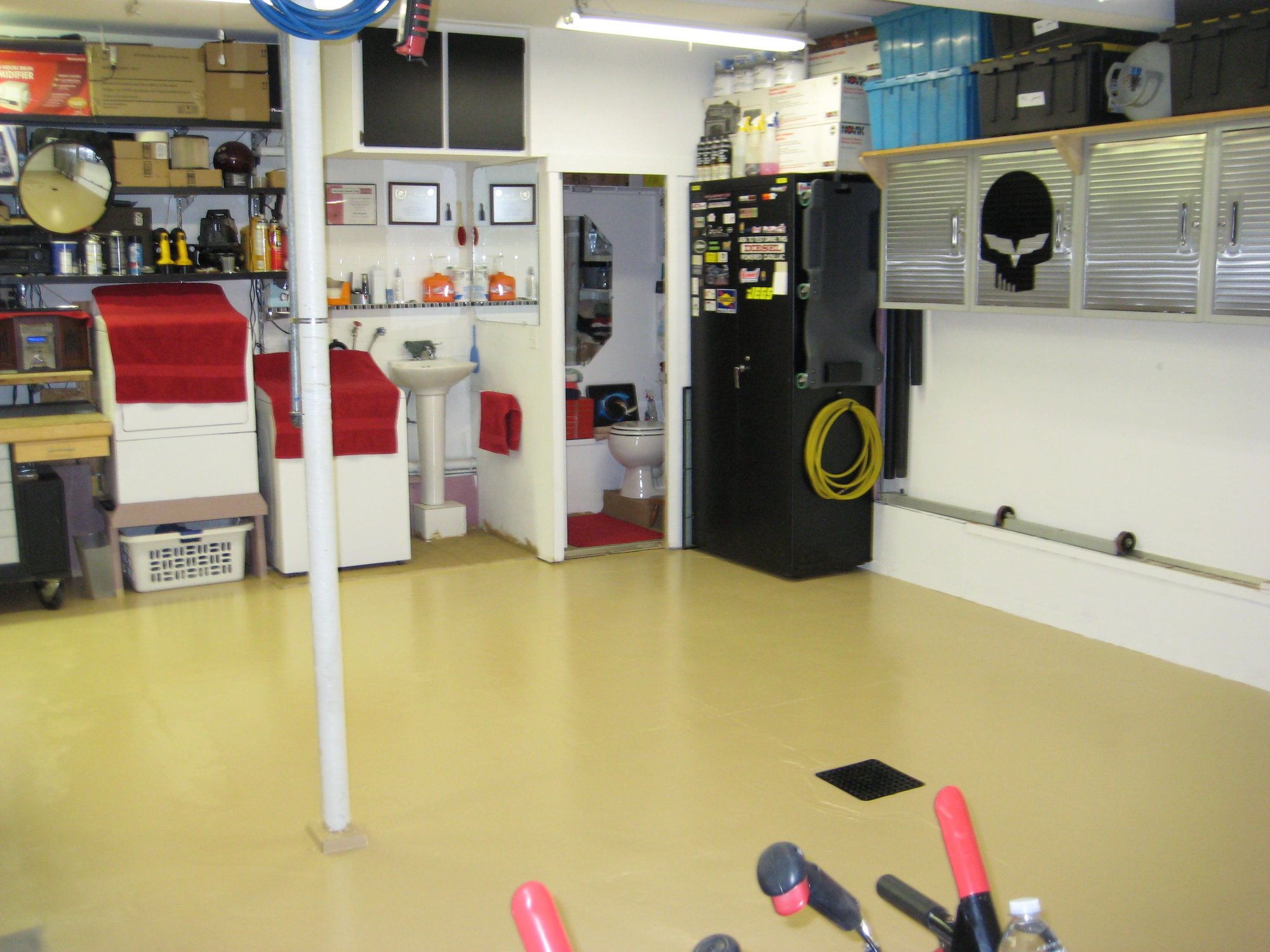

I also used the same only I did two coats, holding up well !!!!!
Sure wished I had a sh_tter in my man cave.

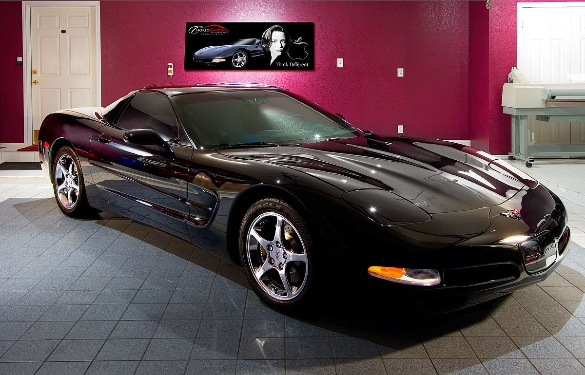

Race Deck in my New Jersey garage. 10 years old, clean it twice a year. Here is a picture after a recent mopping.
I have since added a four post lift to the garage and the Race Deck still holds up very well.
That's all you got ??????
