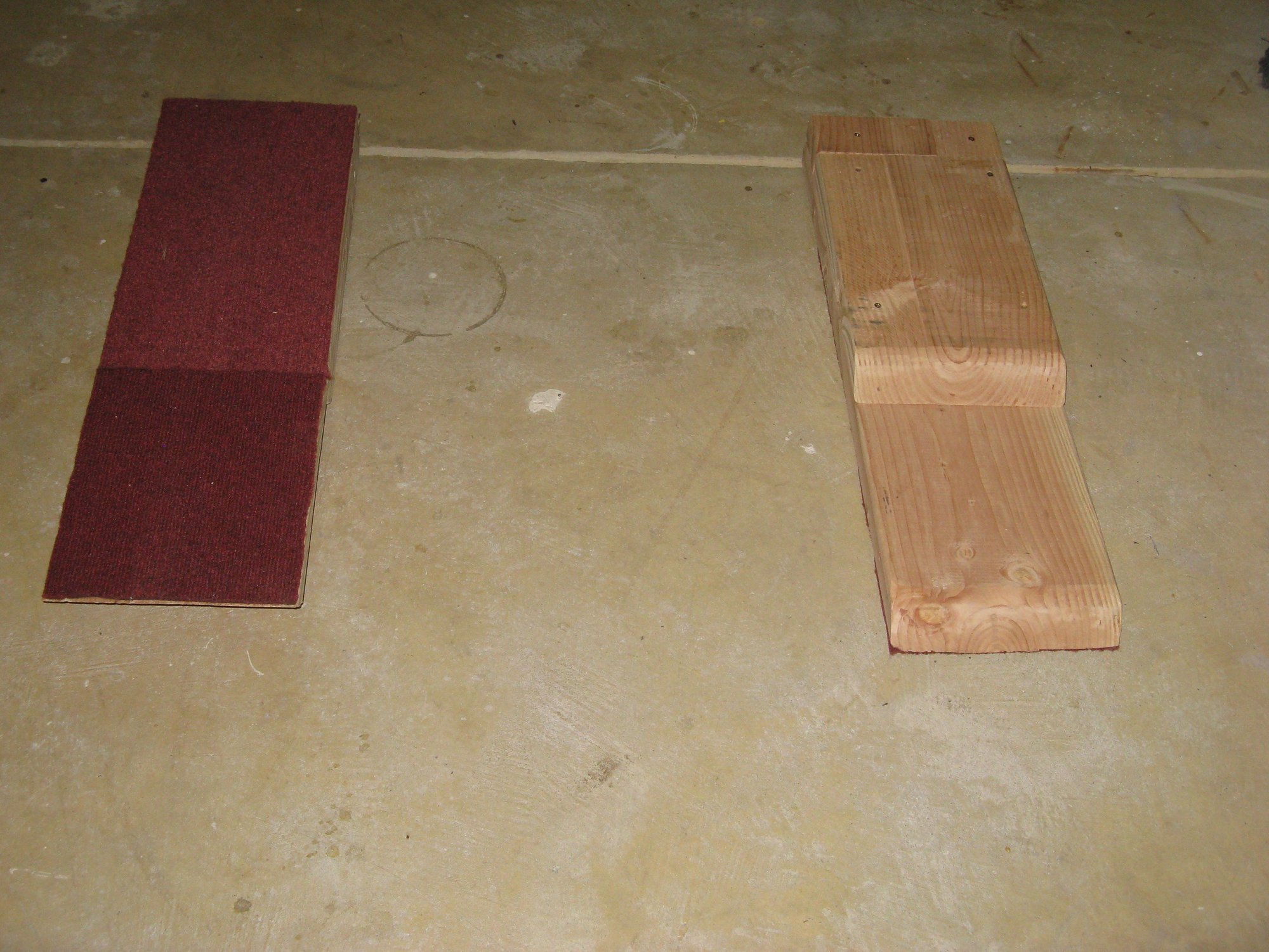

You could also build your own ramps, you can create the incline you want.
I made these from scrap plywood that I was tossing out.
Attachment 48008321
These are brilliant! The neat thing is that with the stoppers you don't need two people. Could I please have dimensions....LxWXH plus length of each piece?
Thanks!!!
Thanks!!!
I was some what restricted on my size because of only using what I had.
3/8" 11.5 x 37" each step is 7" long the top step is a full 8" from the stop and total height is 1-3/4"
All of the sections are nailed together using finishing nails, and the stop is screwed on, if I was to change anything it would be a taller stop which is 3/4" & longer top.

I did the same but with a 12x4 and it works just fine with my car. Those other ramps look great too.

Originally Posted by tommypenguin
Did you put anything on the bottom of them to not slide? Did you only make one to get jacking clearance under front cross member or two so you can do minor work?
Thanks for all the suggestions guys. I have quite a bit of plywood scraps in my basement I could make use of, making 6speedsteve's suggestion the most cost effective.
I did not put anything on the bottom, I have 4, I have only had to use them twice to drive up with no issues, most of the time I use them to drive down after the car has been lifted, if my car is already in the garage I just lift each corner, once that is accomplished I have pictures of some of the other tools both purchased & made to get my car up in the air.
I have 2 of these I use under the control arms front or rear or the puck locations. I mostly use when removing one tire & rim at a time for cleaning.
These are used to lock into the cradles, front on top, rear on the bottom, the jack sits in a pocket of 1/2 plywood so nothing slides, my jack goes to about 24" high
And then I can adjust how high I want to put the car on these from 7 - 13" with all 4 layers & each 2 x 12 has bolts in the corners to keep from sliding & the plastic base is locked to the top 2 x 12
