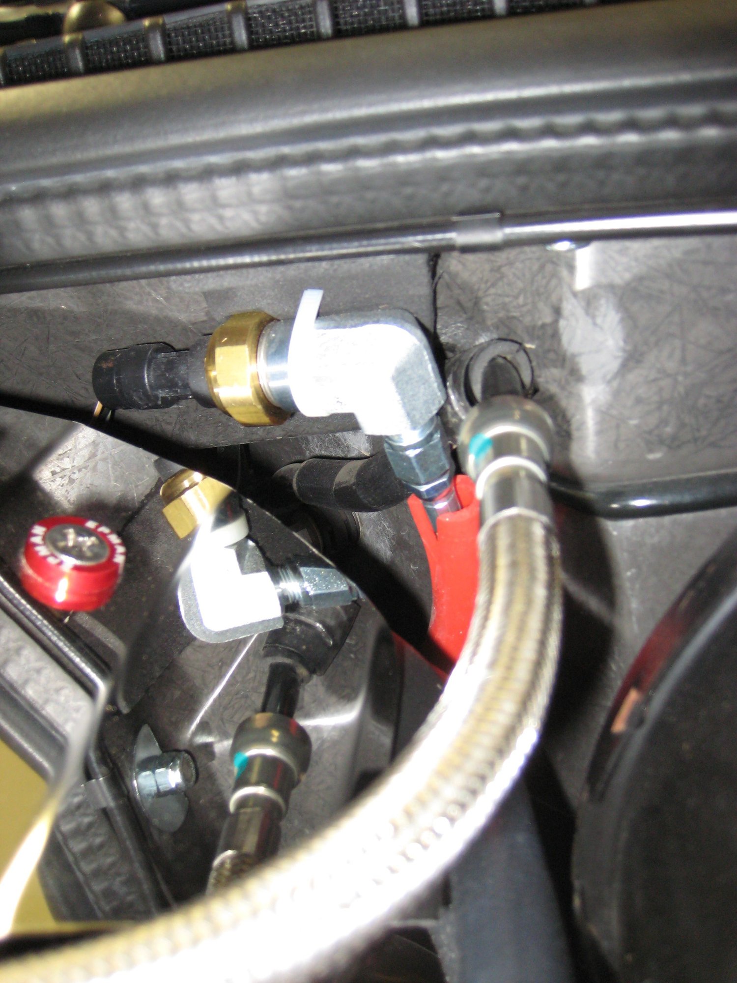

I have posted a similar episode(twice) with my 99 coupe after relocating the oil sensor. In the first 2 years, only under the same overpass, mine dropped to zero, but before I could turn the key it came back to normal psi. This happened 3 times in the two year period. This summer it has done it seven out of nine times, only in this spot. I have had guys here tell me to put tin foil around the sensor, I have not done that yet, so weird
I've been reading about the oil pressure sending units failing on the C5's and when I purchased mine back in April the previous owner made a point of telling me the oil pressure sending unit had been replaced. After spending the past 50+ years working on various vehicles I have never heard of so many oil pressure sending units failing on a given vehicle?? So, would someone please tell me why this is such a common and accepted problem? Repetitive problems with these sending units seem common as well. I have a '95 GMC pickup with 190,000 miles that still has the original sending unit. Is this a problem that could be heat related? If so, does relocating the sending unit eliminate the problem? Just wondering.

It is a combination of a poorly designed part and the fact it is in a bad location. In the factory location it takes on some serious heat and vibration.
since relocating mine, three years and close to 19,000 miles no issues (other than the one stated here)

Well I paid attention to what is around the exit that causes my oil pressure gauge to drop to zero. There are actually two culprits, one is a radio station antenna and about 500 feet or so it drops again after starting to go back to normal, then there is a cell tower ??? I am going to ground the sender and see what happens ???
