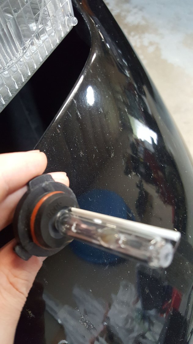

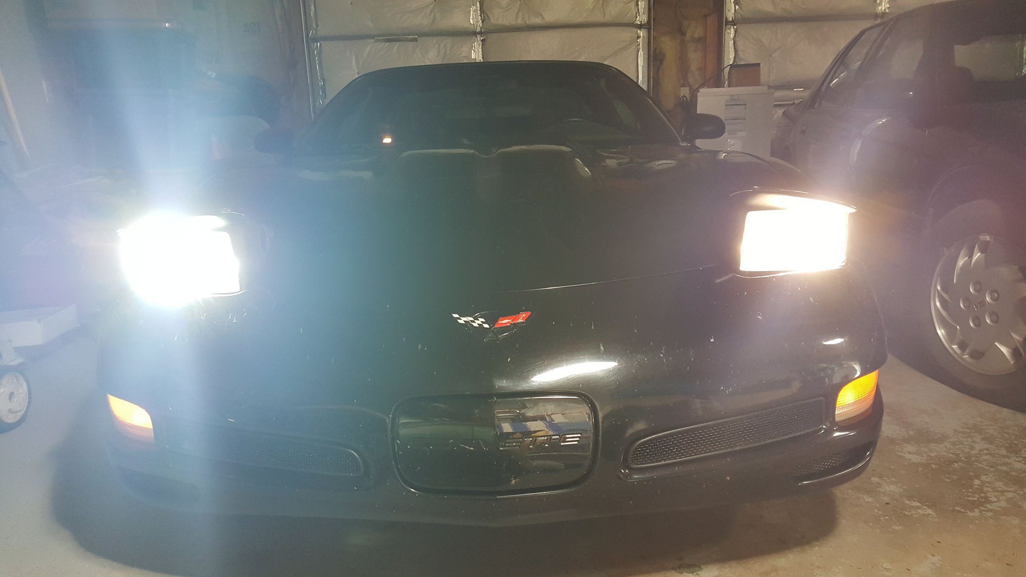

So my car looks like this
As you can see, the colors are off. Idk bought it that way. But what bulb am I needing to get to make them both white? I bought a pair of Philips 9006 CVB2 bulbs and they are not what my other bulb looks like. I wasn't expecting this. This is the bulb I need but it also says 9006? Looks completely different

Looks like a HID to me. Are there ballasts down there somewhere?

Yeah I I believe I saw something that could have been a ballast. Fair enough, well I shall look for some HID's then

Several forum vendors sell HID kits and replacement bulbs. Most consist of a plug-and-play ballast with HID socket. There are many "colors" of bulb. They are listed by temperature in degrees K.

Just look at the picture the OP posted. There is considerably more light cast from the HID bulb.
