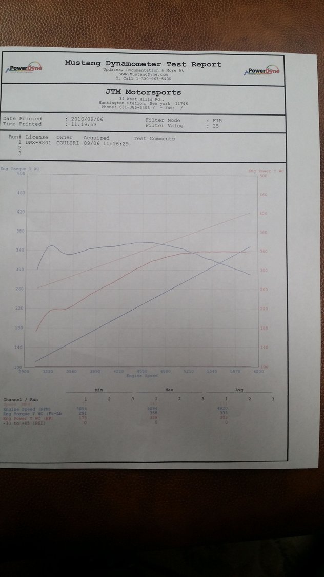

Ok wanted to see what my car put down will post a graph later... mods are xs headers and a vararam 340 to the wheels... not sure what to think? Graph looks great though

Joined: Aug 2015
Posts: 3,116
Likes: 304
And this is a Z? Seems very low.

Mustang dyno, maybe?
They said it was conservative also

The numbers are lower than a stock Z but many things can contribute to both low or over zealous dyno numbers such as the type of dyno used, out of calibration etc. I wouldn't necessarily be too concerned, you could always go to the track to get a trap speed or go to a different dyno just for reference but I'm assuming your low numbers are due to the dyno in some way shape or form.

This is the graph he said timing and afr was right on.. so on a dyno jet I should be around 380hp?

A Dynojet usually gives higher numbers than a MD, but they all vary, and if you're modding, use this as a baseline, not an absolute. Don't worry; If it runs good, it's all right.
I dunno something is probably wrong/off/not calibrated accurately on his dyno if your car is running correctly even on a mustang dyno (which, IMO is the machine to use b/c the dynojets I've used & seen #'s from are usually WAY over zealous/unrealistic) - why do I say this?
My car was dynoed/tuned multiple times @ Slowhawk Performance in MA, known to have one of the stingiest - but truest - dynos around. Mine made 352whp stock, 363 after intake/tune, & 384 after headers/ported TB/retune.

I was wondering if he had the traction control off?

Seems like your car falls flat at around 5100rpm on that graph. That doesn't seem right...even for a stock C5Z.
At that RPM, the power should still be rising.

It's a 04z. What makes me mad is the owner from jtm said everything looked gd... I sent my pcm to doug from ecs then when I Reinstalled the pcm took it for a ride it felt lazy down low not up top weird? Then took it to jtm he said it looked alittle rich down stairs... I called doug and told him now he is calling John from jtm also these guys are buddy's so I hope it turns out ok? What scares me is John is telling me the dyno sheet looks gd.... this is on a dynometer

I am waiting to hear back from John, but that is a Mustang dyno. Also what was the temp when it was dyno'd? timing could have been being pulled from high IAT's. It's been very hot here, that's for sure.
Just speculation since I have not seen the log, but if John said it was on then personally I trust him, what is his benefit in lying? I'll get back to you when I hear from him.

he said it was rich down low, temp outside was about 70 and cloudy no humidity.

look at my dyno sheet that I posted...
To tuned on a dynometer?

I don't understand what you are saying? It's a Mustang dyno, they read low, if the A/F and timing are in place then there's not much more to expect for a car with a cold air intake IMHO.

How do you know everything is not OK? "A little rich down low" takes away next to nothing on HP and wouldn't effect the upper end regardless. I intentionally make most cars a little rich down low, I have found it decreases detonation up top. Not a pig rich mind you, but if it was then he would not have told you it was OK right?
As I said though, you are welcome to come here and I'll data log it for N/C, can't beat that for just a mail order tune that was confirmed "good" by another shop. All shops are in business to make money, if there were any corrections to be made worth making, they would have justifiably taken your money to do so.
