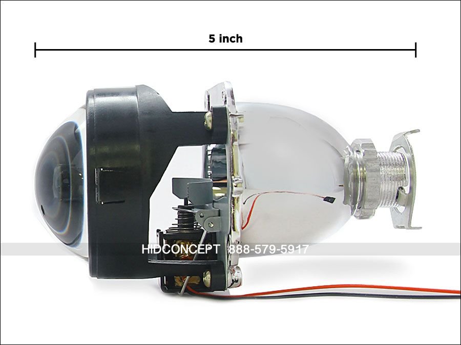

Oh I understand you yes Hid has to have a shutter so that the lightbulb is fired at all times and the only change is the shutter lifting up that way you don't have to warm up process every time you turn the light to lower or higher. I hope I've explained it right I'm sorry if I didn't let me know

I used four bi xenons, two were on low setting for low beam and two were off, all four were on high setting for high beam. Time off delay circuits maintain constant light when going from high to low or low to high.
Why 4 Bi-Xenons? Unless you already had them and decided to use them for this project, the same results could be achieved with just 2 Bi-Xenons and 2 regular high-beam projectors. It would be less expensive and simpler.
Using Bi-Xenons, there is really no need for a time-delay circuit. The only thing needed would be a Hi-4 Harness to keep both projectors on. This way switching from low to high, or vice versa, is instantaneous because the Bi-Xenon is always on at full brightness and therefore it doesn't matter that the high beam takes a couple of seconds to warm up.

That works perfectly with halogens, but with HIDs switching on the high beams wouldn't be instantaneous due to the couple of seconds of warm up time involved.
To have an equivalent result of what you describe using HIDs, you would need to do what Hotrod03 did: use 2 Bi-Xenons and 2 regular high-beam projectors plus a Hi-4 Harness. This way, going from low to high beam, or vice versa, would be instantaneous with no loss of brightness because the Bi-Xenons are never switched off. In other words, with low beam you would have 2 projectors ON throwing "low beam light", while with high beam it changes to 4 projectors ON, all of them throwing "high beam light".

I chose four Moro Mini's so they would all be the same and for the small outside diameter of the shrouds to keep the headlight doors open as little as possible. In 2012 they didn't have as many choices as now and these weren't available sealed. Here's a side shot of the open position:
Low beam
High beam
High beam
Low beam on the garage door
