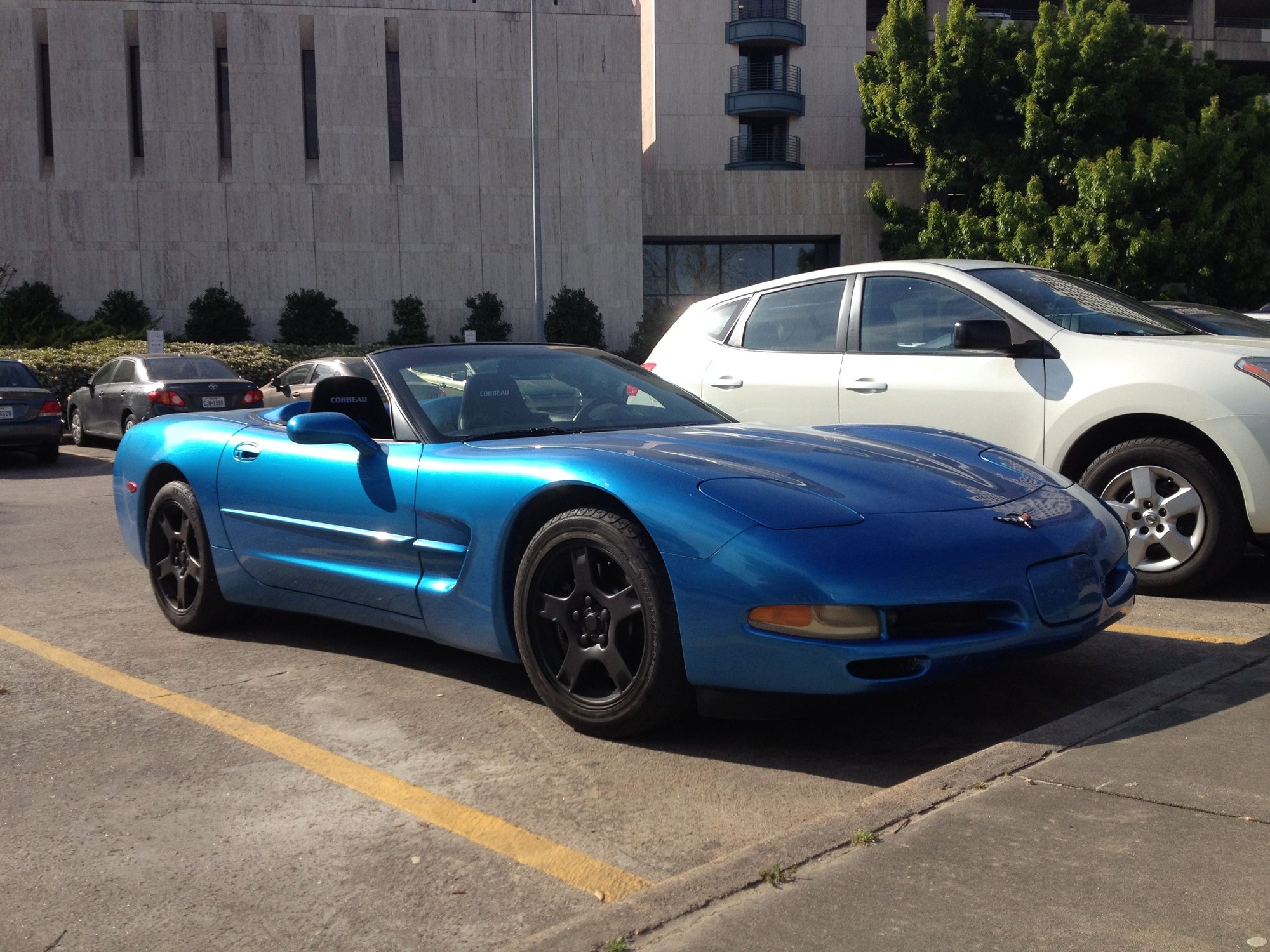

I sprayed mine black, looks good but make sure to clean, wash, and dry the surface so the plastidip can stick to it, or else it will just peel off while shrinking
