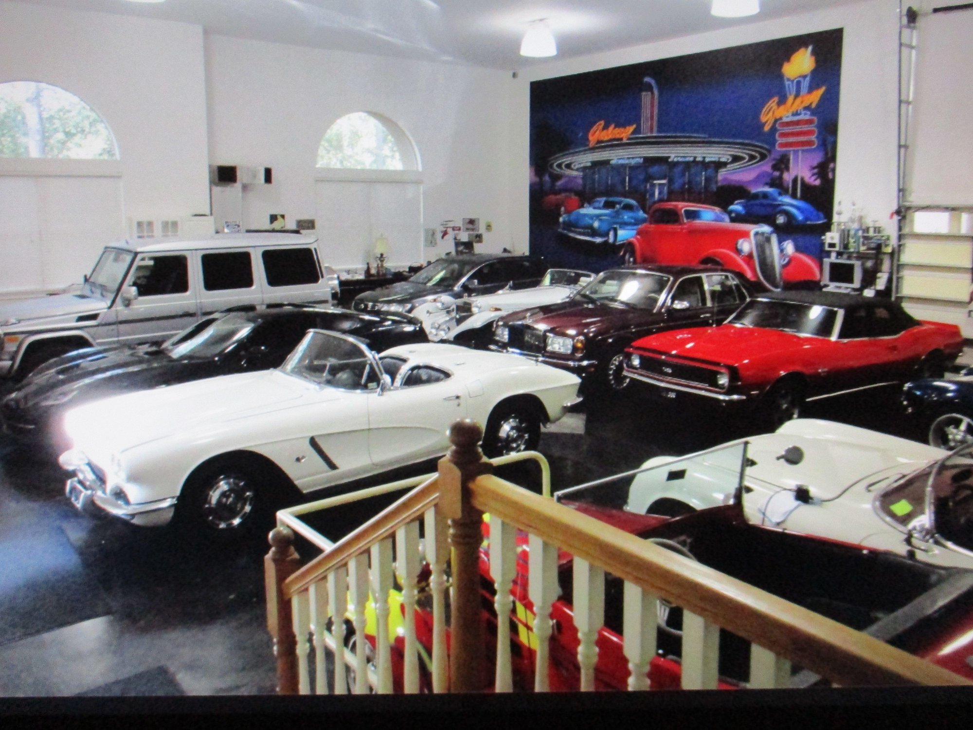

Cut the guy some slack. If OP wants to look at em vs drive them that's his business. It's not our money.
I know a local guy that has like 20 cars. More than one house as well where he keeps the other 10.
See garage below. He enjoys the view. Hardly ever drives any. v v v
btw: I'm working on his '15 Coupe MSRP 73.4
Got a 50th & 40th from him so far.
That (was) a blue Cobra on the far right. Titled as a Shelby American. He sold a Ford GT...made good $$$.
