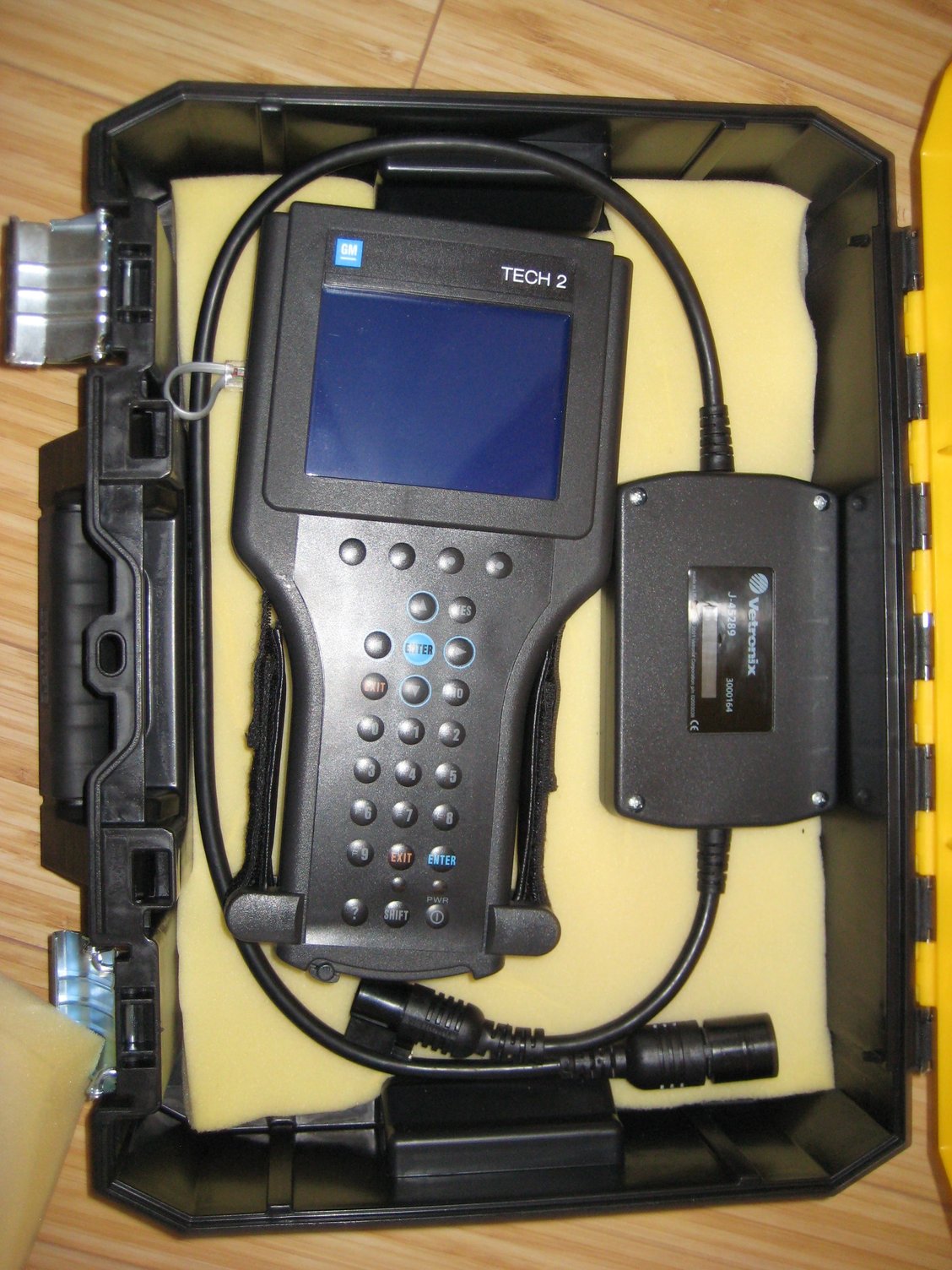

But if you have run flat tires, the sidewalls look normal even if there is zero pressure. The only way to tell is by putting a gauge on them. (or TPMS sensors) So with run flats it is much easier to check the pressures on the DIC than check with a gauge every time I drive it.
On the '01-'04 cars the TPMS can be turned off with a tech 2. That became an option that could be disabled because the Z06 did not use TPMS. The '97-'00 cars can not be disabled like that.

OK showing ignorance - what is tech 2???
Gr
Gr
I t is a high tech tool used by GM Dealerships, although not anymore.

Default Tech 2
Thanks
