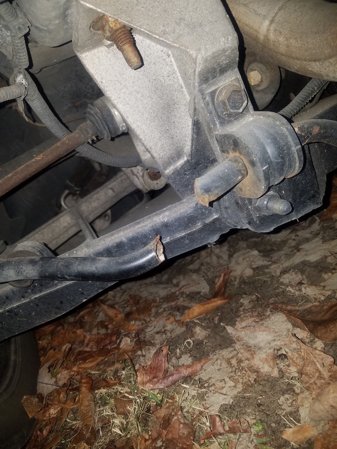

I just crawled under rear of car, sway bar is broken in half..
That wouldn't explain why it suddenly kicked out if you were just going straight. But, it definitely would explain why it was so difficult to recover and took you on a wild ride before coming to a stop.

WOW never seen a broken sway bar.. Not good..
I haven't either.
Old Dec 9, 2016 | 05:28 PM
leadfoot4's Avatar
leadfoot4
Active Streak: 90 Days
Joined: May 2001
Posts: 87,375
Likes: 1,593
From: Western NY
I've never seen one in person, but I seem to recall that there were reports here, of a few, a couple of years back....

Old Dec 9, 2016 | 06:44 PM

Originally Posted by moekluse
Rust?

Originally Posted by Studying4boards
Rust?
I'm willing to bet it broke with previous owner and I just now realized it, which is why it's rusted. either that or it snapped because it was rusted

That is a perfect excuse to upgrade to thicker sways.
Maybe it hit a serious pot hole over and over.
Would the rear sway bar cause the problem mentioned? The base C7 doesn't even come with one (similar style suspension).
I don't think it caused the traction break but I'm sure that's why it was so difficult to get under controll
