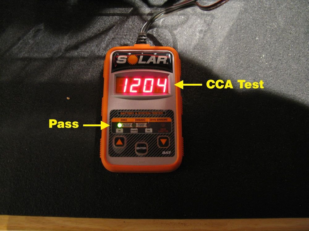

This is the new replacement Odyssey I received a couple days ago, and right out of the box it tested 354 CCA ABOVE the 850 rating before I even put it on my CTEK charger and installed it in the car!:
I got even better test results after giving it a full charge on the CTEK overnight. Car feels like it starts now before I even turn the key!
