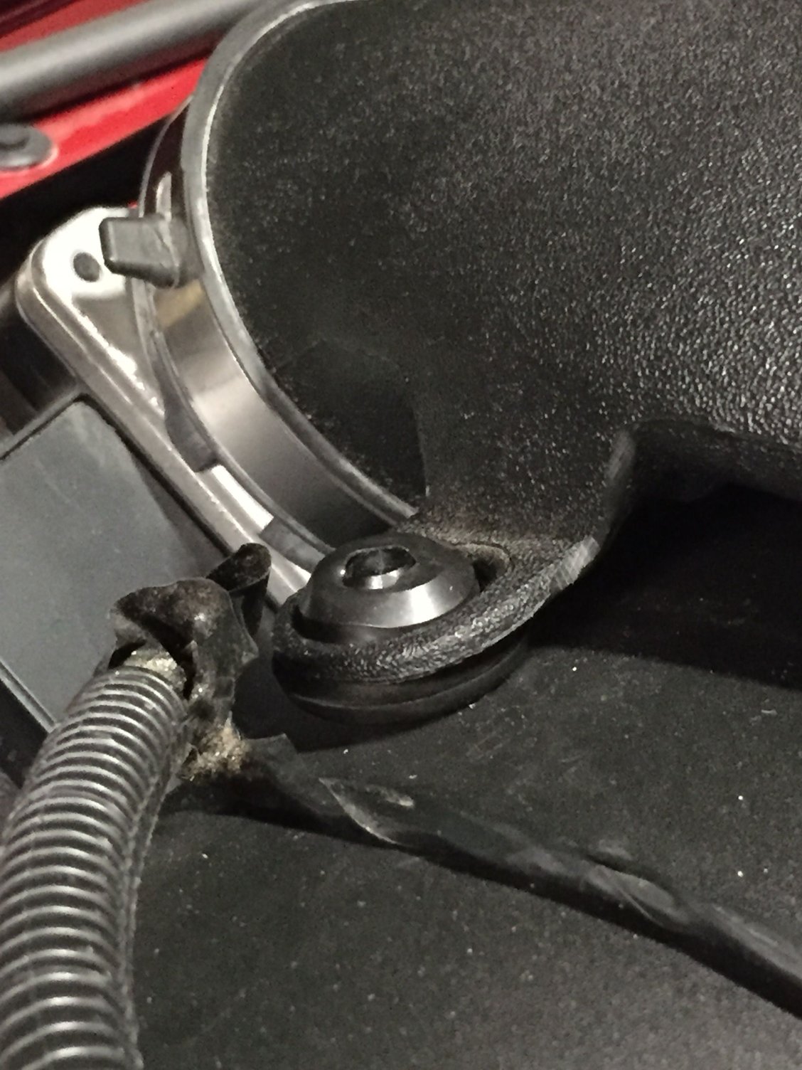

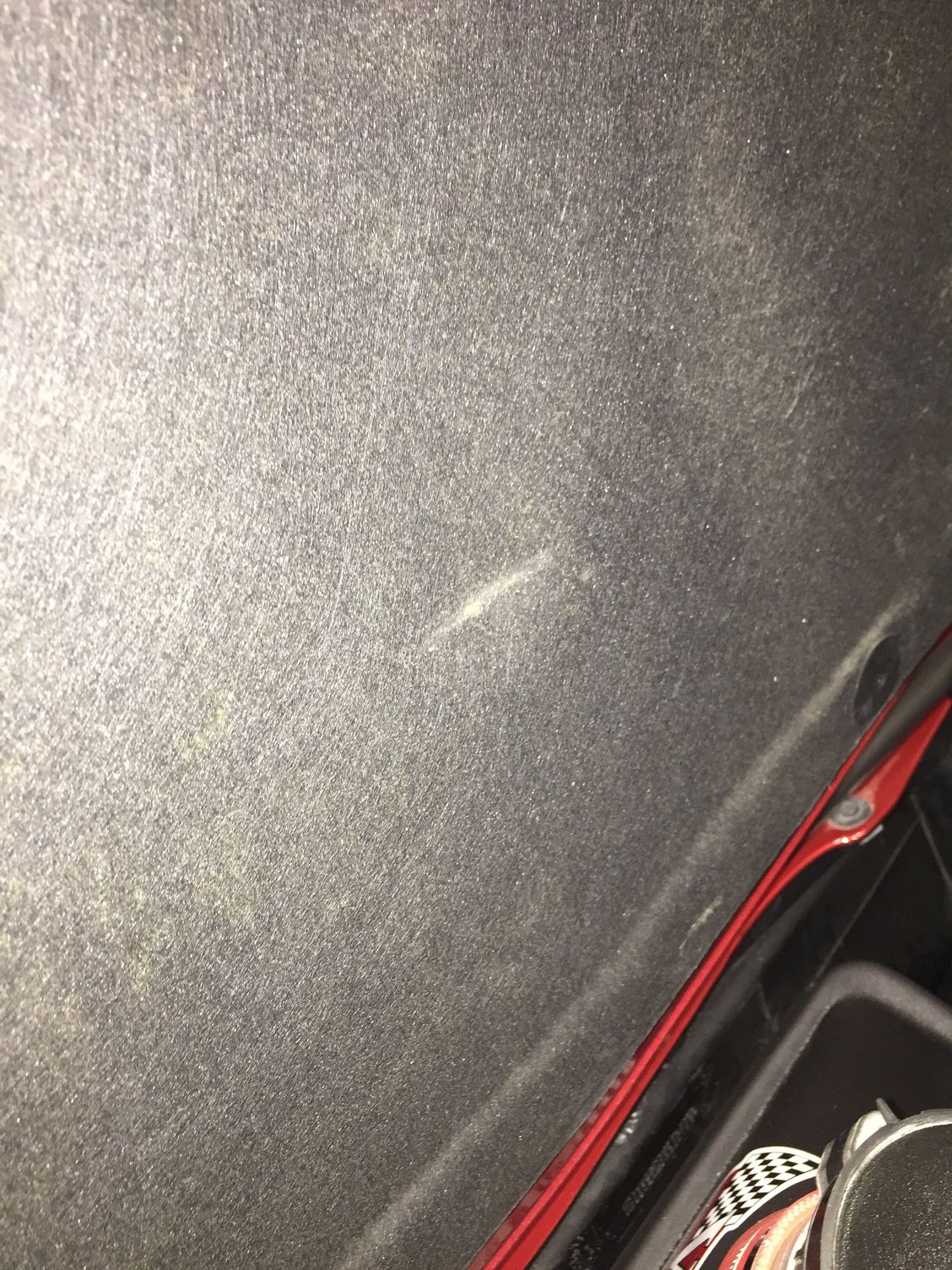

I tried this in the Tech section but didn't get many responses. I just installed my Vararam without the power duct. The MAF is contacting the liner where it connects to the air bridge. Because the Vararam filter box is contacting the shroud, I cannot get the air bridge push pins in completely so the bridge sits flat on the radiator bracket. Is this normal? Has anyone else experienced this and if so, were you able to fix it.

I have been running my VeraRam for 2 years without the push pins and no problems. While my mileage was low in this time my driving was not. Almost 3000 miles of HPDE and autocrossing on the engine. This fall before putting it up for winter, I removed the air bridge (stock) for some MAF and TB cleaning and not a scratch on the radiator cover. The reason I did not put the push pins in is I lost them while installing the VeraRam--probably threw them away with the box. Since the VR airbridge would add nothing to a stock engine I never bought one. Then I tuned the car for autocross performance.

Thanks for the reply. I trimmed a 1/4 inch off the filter box and coupler. Sits much better now. But a nut and bolt would work well. Thanks again.
