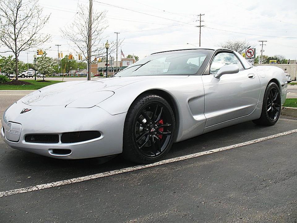

Attachment 48051673

Don't forget to paint calipers black
no red !!!
