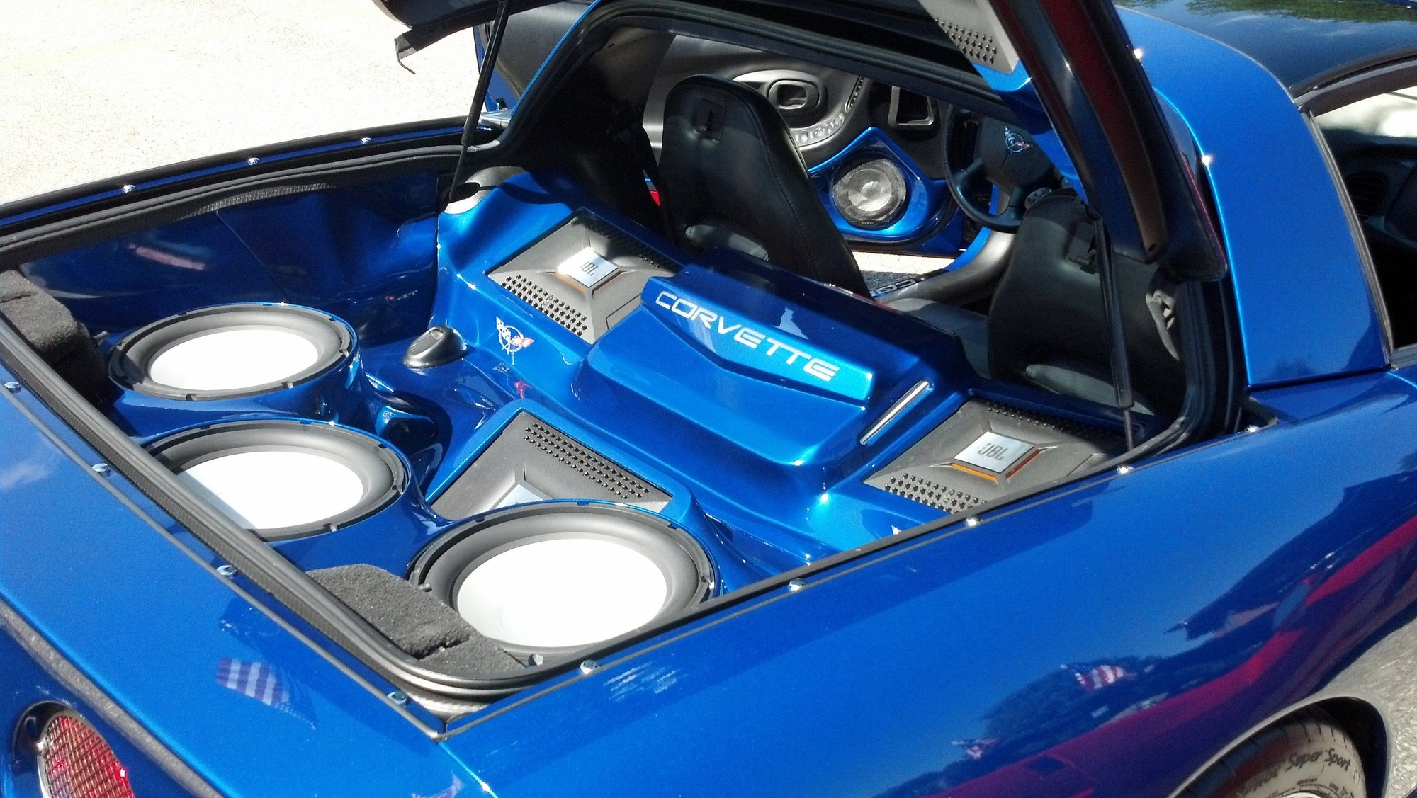

I agree, water and electronics are bad together but what's electronic about a C5's rear speaker?
IMO, a speaker is not electronic, the radio yes, amplifiers yes, crossovers, yes.
My Infinity Perfect subwoofers are poly, you can pour water in them and NOTHING will happen. The JBL amps are a different story.
